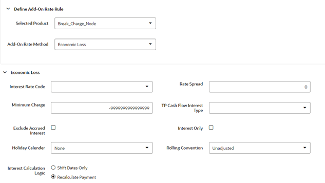

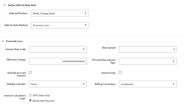

6.3.5.4.1.2 Breakage Charge – Economic Loss
The Economic Loss Breakage Charge Method sets out to compute the cost to the organization (economic loss) incurred for terminating the funding liability (also known as the shadow liability). The calculation assumes the funding liability has the exact attributes of the funded/terminated instrument.
Figure 6-279 Breakage Charge - Economic Loss
The rate of the funding liability is equal to the Transfer Rate. Economic Loss is computed as follows:

If you are calculating Breakage Charges, using the Economic Loss method, you must select the "Remaining Term" option in your Transfer Pricing Process, to generate the correct Cash Flows for the funding liability.Both Current and Prior Period Cash Flows will be logged which are used for Break Charge Calculations in FSI_O_CFE_OUTPUT_HIST table using the Record Sequence (n,n+1) for Prior/Current Period Record, respectively. Record sequence is concatenated with Account Number, so you can identify Cash Flows belonging to prior/current period record.
