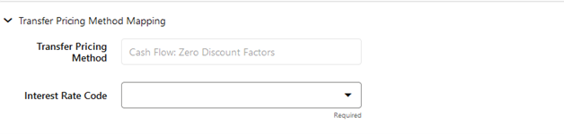

Figure 6-242 Cash Flow: Zero Discount Factors
