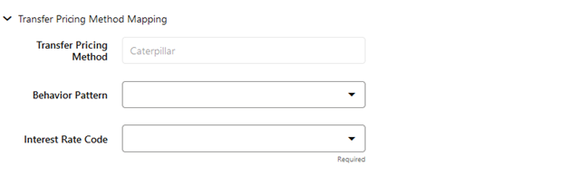

6.3.4.1.11 Caterpillar
The Caterpillar Method extends the concept of Strip Funding to instruments that do not have contractual Cash Flows. These products are known as Perpetual or Non-Maturity Products and therefore do not generate contractual Cash Flows. The process of determining Transfer Rates requires adopting the 'Strip Funding Approach' by splitting these products into 'Core' and 'Volatile' portions based on statistically established Behavioral Profiles. With this approach, the volatile portion may be considered as an overnight funding strip and the core portion can be dealt with by an assumed maturity structure defined through a Behavior Pattern. For example, statistical analysis may imply that the Savings Account portfolio behaves 20% as volatile and 80% as the core of which the maturity is likely to be 3 months. Therefore, the Funding Strips that would get created are 20% 1 month, and 80% 3 months.
Figure 6-250 Caterpiller
Table 6-73 BEHAVIORAL PATTERN: 20% 1 Month; 80% 3 Months
