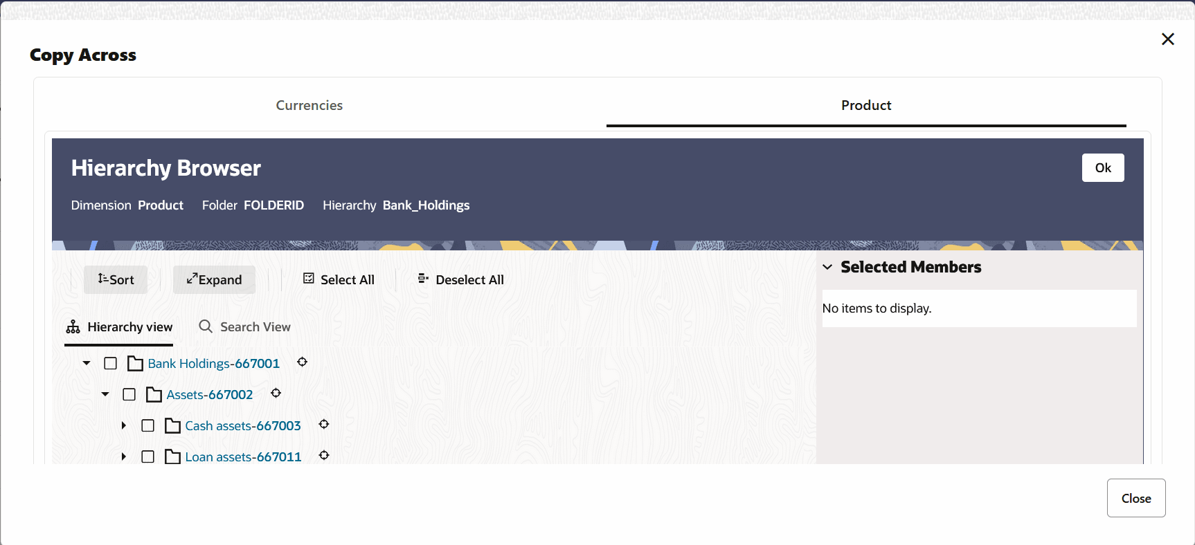

  5. On the Copy Across dialog, select the Product tab. Select the relevant leaf from the Hierarchy browser.
    Figure 6-263 Product Hierarchy
    Product Hierarchy
  6. Click Ok to initiate the copy process and to return to the Assumption Browser page.
