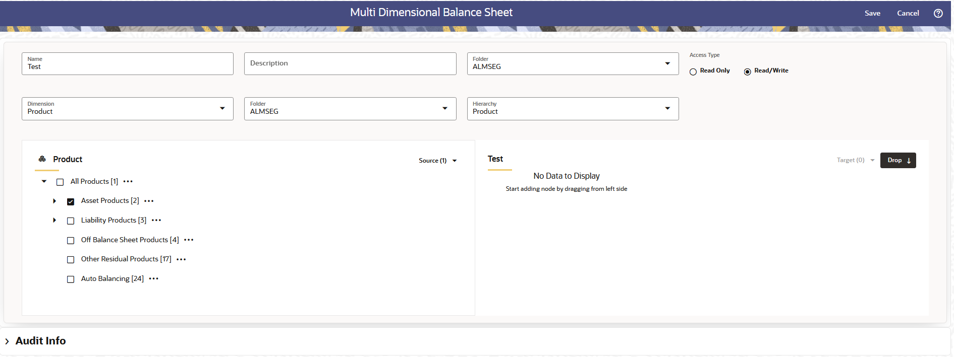

    • If Dimension is selected as “Product”, then Product Folder and Product Hierarchy fields will be available.
      Figure 6-18 MDBSS Rule

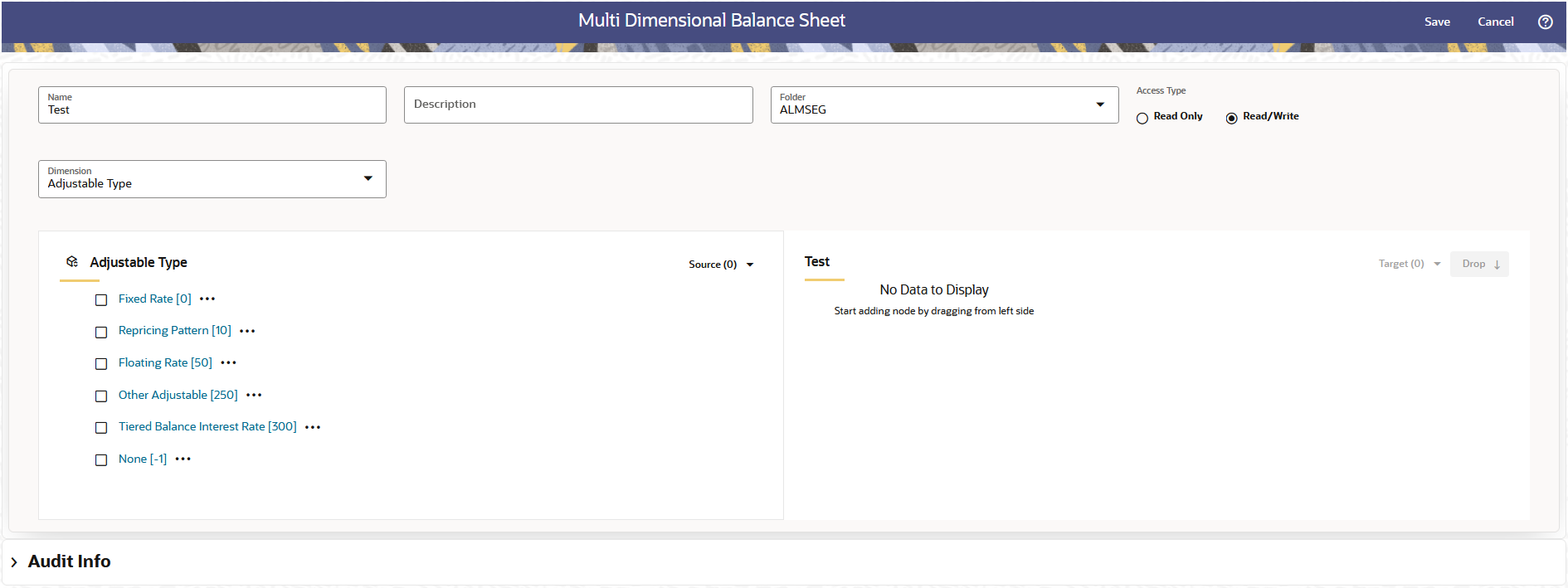

    • If Dimension is selected as “Adjustable Type”, then only list of Adjustable Types will be available.
      Figure 6-19 MDBSS Rule

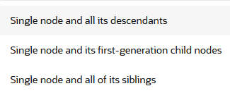

      • Single node and all its descendants: Allows to select node itself along with its descendants.
      • Single node and its first-generation child nodes: Allows to select node itself along with its child nodes
      • Single node and all of its siblings: Allows to select node itself along with its siblings nodes

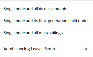

    • When node is moved to Target section, then following options are available:
      Figure 6-21 MDBSS Rule
      MDBSS Rule
      • Autobalancing Leaves Setup: Allows you to setup the Autobalancing for selected node as Asset, Liability, or Retained Earning.

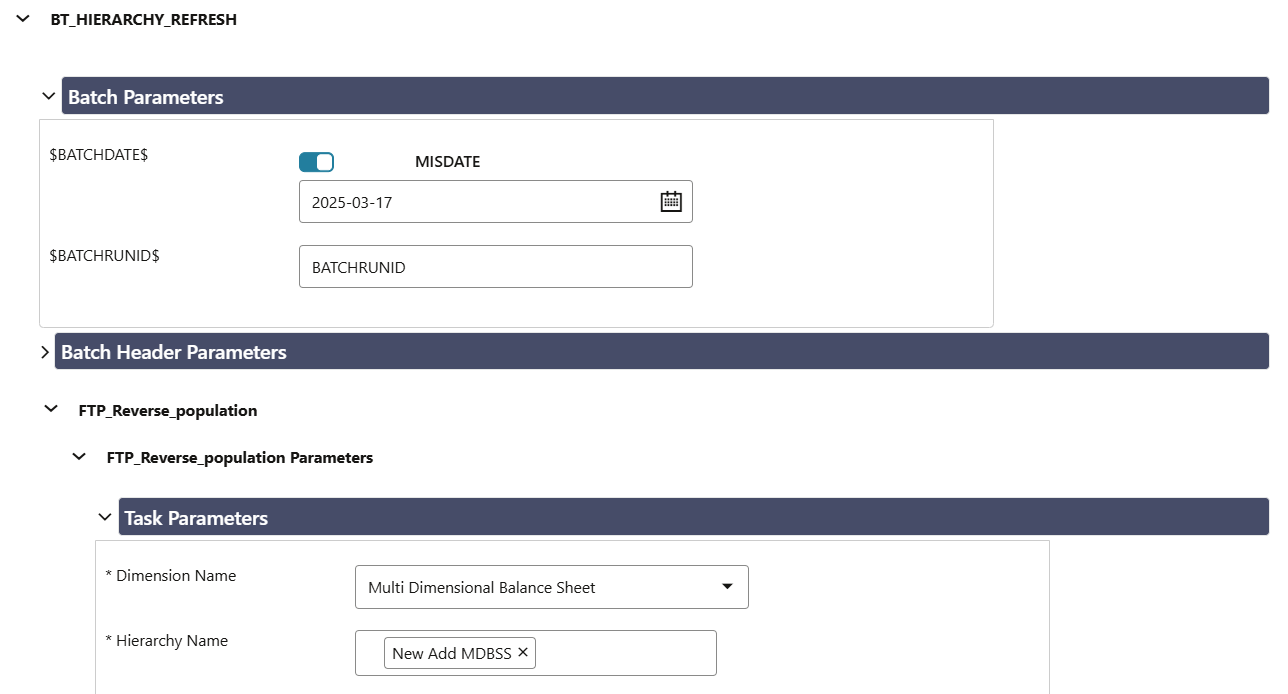

  2. Navigate to Operations and Process from LHS, then select Scheduler, and then select Schedule Batch.
  3. Search for the batch 'BT_HIERARCHY_REFRESH'.
  4. Click Edit Parameters.
    1. Select Dimension Name as "Multi Dimensional Balance Sheet".
    2. Select pre defined Hierarchy from Hierarchy Name drop-down.
    Figure 6-22 Batch Details
    Batch Details
  5. Execute the Batch. For more information, see the Scheduler Service. After batch execution, MDBSS data will be loaded in the table OFSA_IDT_ROLLUP.
