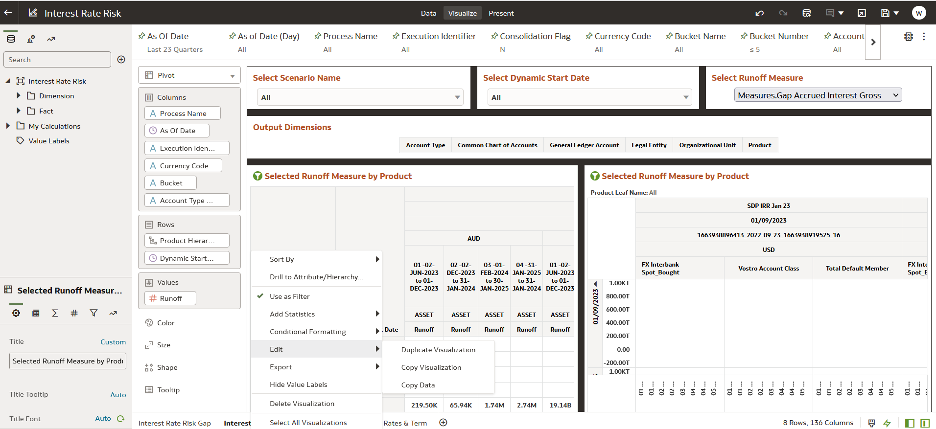

  1. Navigate to Interest Rate Risk report and click Interest Rate Risk Runoff.
  2. Right click on the dimension and select Edit.
  3. Select Duplicate Visualization.
    Figure 8-279 Duplicate Visualization
    A copy of the report is created.

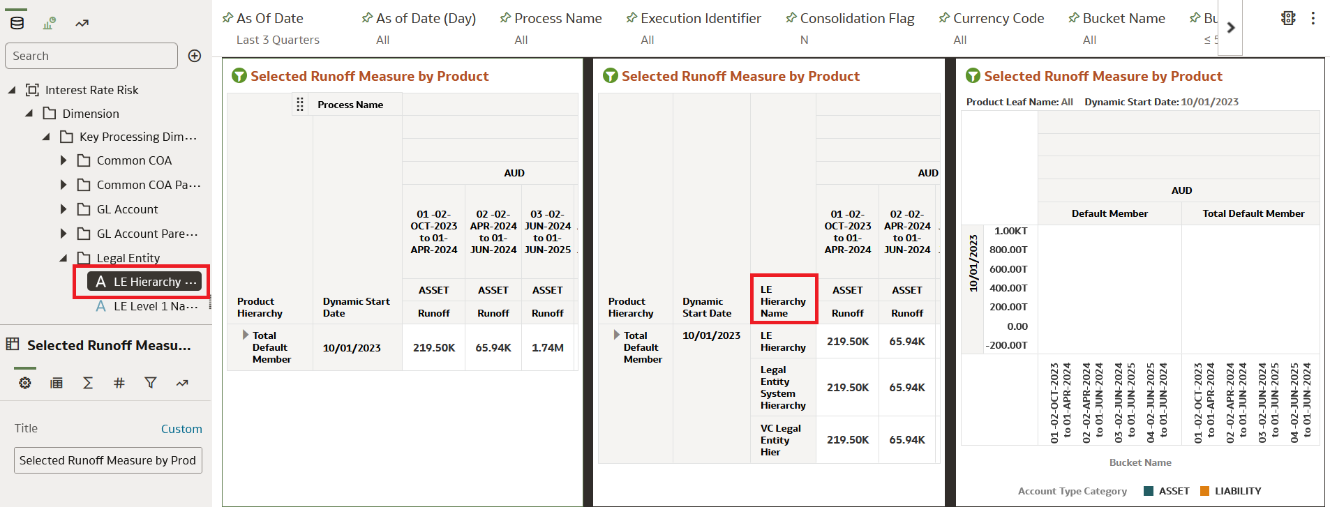

  4. Click on the Rows to view the dimension.
  5. Navigate to Dimensions under Interest Rate Report
  6. Select the dimension type and column name.
  7. The report will be displayed based on the selected dimension. The new report is displayed based on selected the dimension.
    Figure 8-280 Customized Report
    Customized Report
