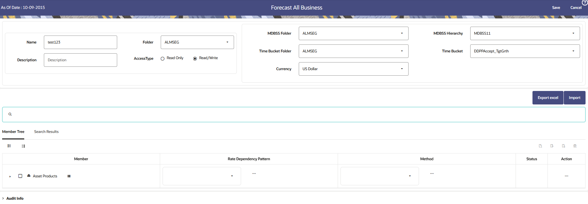

6.3.3.4.2 Create Forecast All Business Rule
To create a new Forecast All Business Rule, follow these steps:
  1. Click Add icon from the top of the Forecast All Business Rule Summary page.
    Figure 6-180 Forecast All Business Rule Page
  2. Enter the following Details.
    Table 6-47 Create Forecast All Business Rule
    Fields Description
    Name Enter the name of the Forecast All Business Rule.
    Description Enter the description of the Forecast All Business Rule. This is an optional field.
    Folder Select the Folder where the Forecast All Business Rule needs to be saved.
    Access Type Select the Access Type as Read-Only or Read/Write.
    MDBSS Folder and MDBSS Hierarchy Select the MDBSS folder and MDBSS hierarchy
    Time Bucket Folder and Time Bucket Select the Time Bucket folder and Time Bucket
    Currency Select the currency for Forecast All Business Rule

  3. Select MDBSS node(s) from Member Tree tab of Assumption Browser. Assumption Browser has two tabs: Member Tree and Search Results.
    • Member Tree: Member Tree tab shows the hierarchical structure and allows you to define rules by selecting the node members from the browser. Select Node and Click Menu icon next to it to view the available options.

      Status of node is also displayed in Member Tree section, for example Selected, and so on. To select member hierarchy, following options are available:
