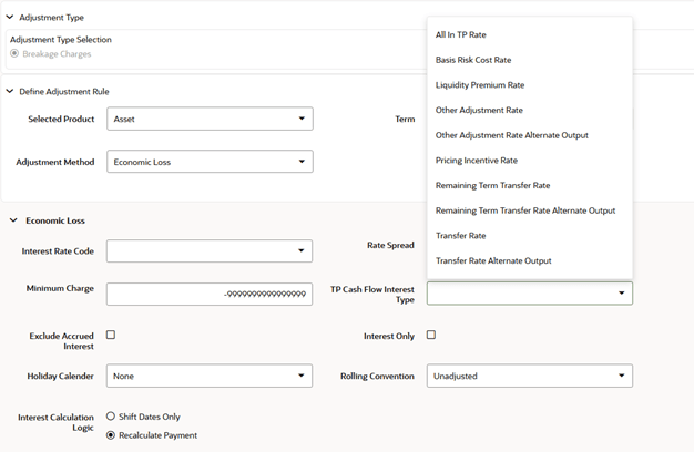

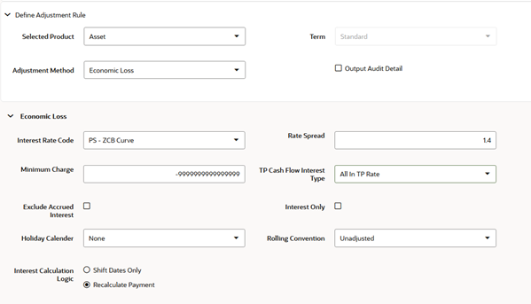

Figure 6-277 Add-on Rule Definition Mode – Breakage Charge (Economic Loss) Calculations
  1. Select the Interest Rate Code and Rate Spread to use for discounting the remaining term Cash Flows.
  2. Select the minimum charge amount. Default to -99999 if you want to calculate both gains and losses.
  3. Select the TP Cash Flow Interest Type. This interest rate will be used to generate Interest Cash Flows.
    Figure 6-278 Add-on Rule Definition Mode – TP Cash Flow Interest Type
