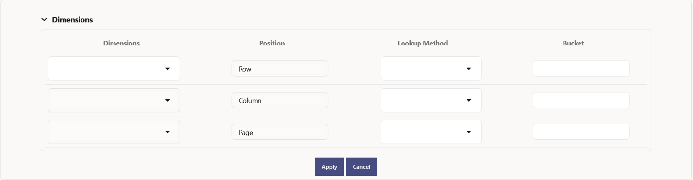

Figure 6-101 Dimensions section
Dimensions section
  1. Enter the following details in Dimension section:
    • Dimensions: Select the Dimension, such as Repricing Term, Rate Ratio, and others.
      The Dimension Section Influences the Prepayment Behavior of an instrument. You can build a Prepayment Model using up to three Prepayment Dimensions. Each dimension maps to an attribute of the underlying transaction (For example, age/term or rate and so on) so the Cash Flow Engine can apply a different Prepayment Rate based on the specific characteristics of the instrument.
    • Position: Shows the position of dimension as Row, Column or Page.
    • Lookup Method: Select the Lookup Method for selected Dimension. It is used to calculate Prepayment Rates for the Prepayment Dimension Values that do not fall exactly on the defined Pre­payment Dimension Nodes. Oracle Asset Liability Management offers the following Lookup Methods:
    • Interpolation: Under this method, the Prepayment Rates are determined by calculating an exact value on an axis. This method assumes that Prepayment Speeds change on a straight-line basis between the two nodes and calculates accordingly.
    • Range: Under this method, the prepayment rates are determined by calculating a range of values on an axis. This method assumes that the Prepayment Speed will remain the same for the entire range.
