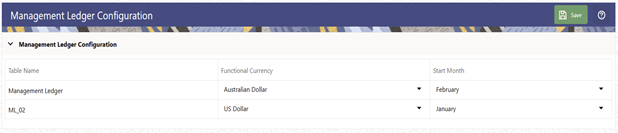

Figure 6-62 Management Ledger Configuration
- Select the following details:
- Functional Currency: This field
allows to select the functional currency that is applicable to the
ledger table.
Accounts and Instruments can be defined across various currencies, but to consolidate the accounts at multiple hierarchy Levels, across units, a common currency is required which you can set here. This currency can be the currency used in the primary economic environment where an entity operates, or in other words, the main currency used by a business unit.
The default value of Functional Currency for any Management Ledger table is set as ‘US Dollar’.
- Start Month: The field is used to select the start month of the fiscal year. The default value of Start Month for any Management Ledger table is set as ‘January’.
- Table Name: This field displays the logical name of the Management Ledger table for which you want to input the details. The physical name of the Management Ledger table is displayed in a toolkit on mouse-hover over the logical name of the table.
ledger table.
- Click Save.
