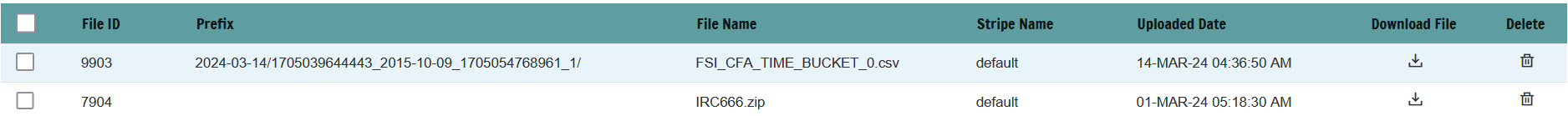

Save the task and execute the batch with Batch ID and MIS Date. For more information, see the Scheduler Service.After the batch is completed successfully, navigate to Data Management Tools, select the Data File Administration, and then select File Upload and Download. Download the exported file from object store.
Figure 4-78 ALMCS Output Export
If you want to execute more than 10000 records, then part files are created with a suffix number such as _1, _2 and so on and will be added to Name of these files.
The File Name Column shows the name of file with Part number. The Prefix is displayed as a combination of As of Date, Process ID and Run execution ID.
