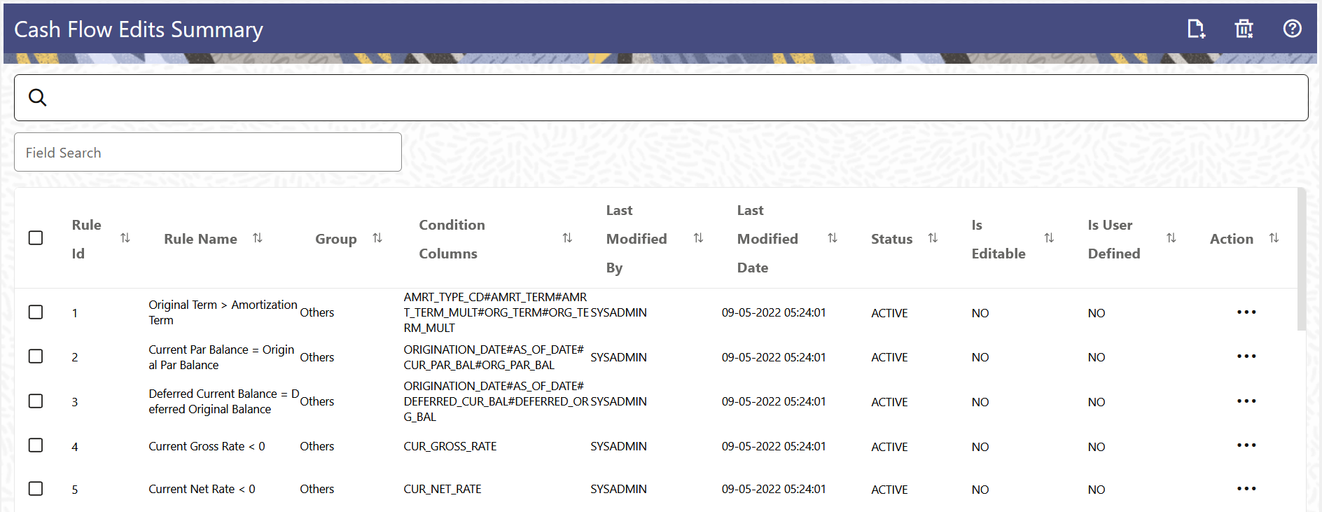

Cash Flow Edits Rule Summary
This page is the gateway to all Cash Flow Edits Rules and related functionality. You can navigate to other pages relating to Cash Flow Edits Rules from this point.
Figure 4-71 Cash Flow Edits Summary

The Cash Flow Edits summary displays the following information:
Add: Click Add icon at the top right of the summary page to build a new Cash Flow Edits rule.
Multiple Delete: Enables you to select and delete one or multiple rules in the table simultaneously.
- Rule Id: The code of Cash Flow Edits rule.
- Rule Name: The Cash Flow Edits Rule's short name.
- Group: The Group of Cash Flow Edits Rule.
- Condition Columns: The Columns on which of Cash Flow Edits Rule is made.
- Last Modified By: The user who last modified the Cash Flow Edits Rule.
- Last Modified Date: The Date and Time when the Cash Flow Edits Rule was last modified.
- Status: The Status of Cash Flow Edits Rule.
- Is Editable: The editable status of Cash Flow Edits Rule.
- Is User Defined: The user defined status of Cash Flow Edits Rule.
- Action: Click this icon to view a list of
actions that you can perform on the Cash Flow Edits Rule.
