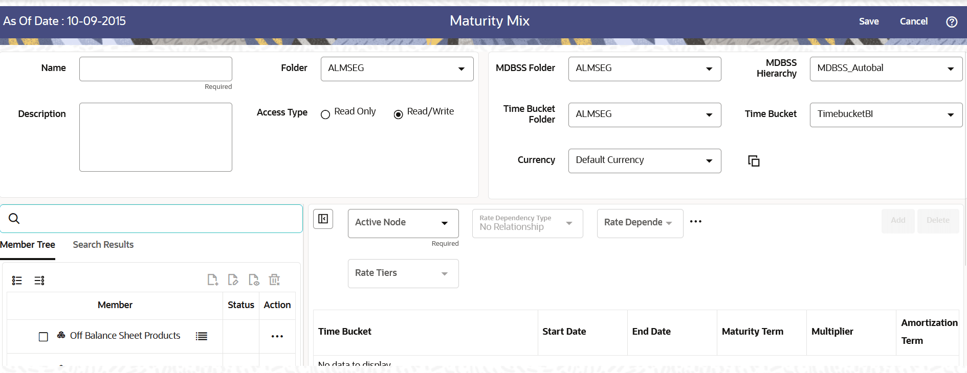

Figure 6-201 Maturity Mix Page
To create a new Maturity Mix Rule, follow these steps:
- Click the Add icon from the top of the Maturity Mix Summary Page.
- Enter the following Details.
Table 6-49 Create Maturity Mix Rule
Fields Description Name Enter the name of the Maturity Mix rule. Description Enter the description of the Maturity Mix rule. This is an optional field. Folder Select the Folder where the Maturity Mix rule needs to be saved. Access Type Select the Access Type as Read-Only or Read/Write. MDBSS Folder Select the MDBSS folder MDBSS Hierarchy Select the MDBSS hierarchy Time Bucket Folder Select the Folder from which you want to apply Time Bucket rule. Time Bucket Select the time horizon/aggregation for process Currency Select the currency for the Maturity Mix rule Note:
If any member is a currency in the MDBSS hierarchy (for example, INR) and selected currency is different (for example, USD), then the member and its children nodes can not be defined.
