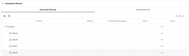

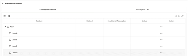

6.3.5.2 Defining Add-on Rate Methods
The definition of Add-on Rate Methods is part of the Create or Edit Add-on Rate Rule.
Oracle Funds Transfer Pricing Cloud Service provides you with the option to copy, in total or selectively, the Product Assumptions contained within the Add-on Rates Rule, Transfer Pricing, and Prepayment Rules from one currency to another currency or a set of currencies or from one product to another product or set of products.
