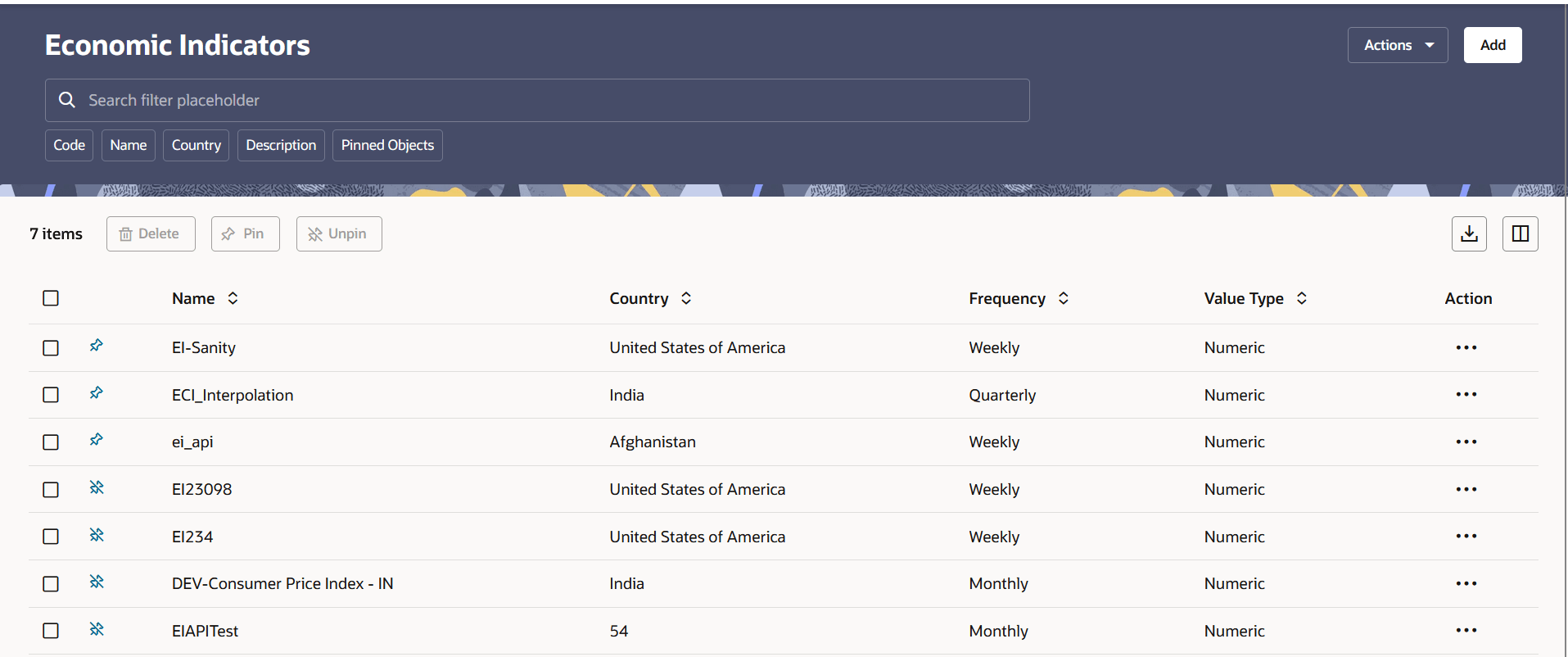

Figure 6-14 Economic Indicator Summary

The Economic Indicator Rule summary displays the following information:
Add: Click the Add icon on the page header to build a new Economic Indicator Rule.
Actions: Enables you to perform following tasks.
  • Refresh: Retains the selected filters and refreshes the summary page with latest status.
  • Reset:Clears the selected filters and refreshes the summary page.
  • Help:Redirects you to latest documentation.
Delete: Enables you to select and delete one or multiple rules in the table simultaneously.
Pin/Unpin: Enables you to pin/unpin the selected rule.
Export: Enables you to download the summary page details in .CSV format.
Columns: Allows you to view the summary page data using a customized list of columns.
The Economic Indicator Rule summary table displays the following columns:
  • Name: The Economic Indicator Rule's name.
  • Country: The Country of for which Economic Indicator has been defined.
  • Frequency: The Frequency at which value of Economic Indicator is expected to be updated.
  • Hierarchy: Hierarchy that is used to define Economic Indicator Rule.
  • Value Type: The Value Type of an Economic Indicator.
  • Action: Click this icon to view a list of actions that you can perform on the Economic Indicator Rule.
    • View/Edit: Based on the user privilege assigned, you can either only view or edit existing Economic Indicator Rules. To edit a rule, you must have Read/Write privilege.
    • Save As: You can reuse the Economic Indicator Rule by saving it under a new name thus saving time and effort in entering data multiple times; it also leads to reduced data entry errors.
    • Delete: You can delete Economic Indicator Rules that you no longer require. Note that only Economic Indicator Rule owners and those with Read/Write privileges can delete Economic Indicator Rules. A Economic Indicator Rule that has a dependency cannot be deleted. A rule cannot be retrieved after deletion.
    • Dependency Check: You can perform a dependency check to know where a particular Economic Indicator Rule has been used. Before deleting a rule, it is always a good practice to do a dependency check to ensure you are not deleting Economic Indicator Rules that have dependencies. A report of all rules that utilize the selected Economic Indicator Rule is generated.
