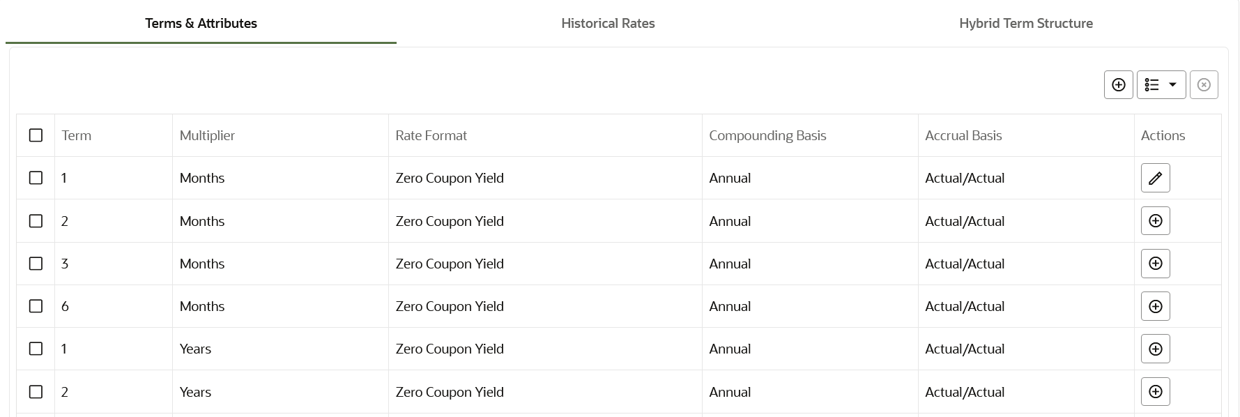

The Terms & Attributes Tab displays the following fields:
- Adding New Term Points: Click Add to add
a new row. (New term points by entering a Term value and selecting a Multiplier
(such as 7 days, 2 months, 5 years, and so on). Rate Format, Compounding Basis, and
Accrual Basis can be selected for the term point. Zero Coupon Yield, Annual,
Actual/Actual are the pre-selected values in UI which you can modify.
One Yield Curve can have two combinations of attributes. For example, first 3 term points have Zero Coupon Yield, Annual, Actual/Actual attributes and remaining term points are Yield to Maturity, Annual and 30/360.
Figure 6-10 Terms and Attributes Tab
Click “+” at the term point where you want to modify attributes. Rate Format, Compounding Basis, and Accrual Basis fields are enabled for modification.
