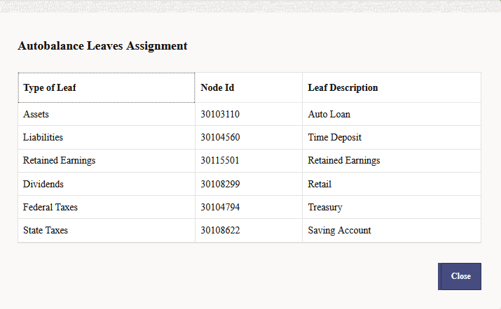

Creation of Autobalancing leaves under Reference Data -- Multi-Dimensional Balance Sheet
As a prerequisite step we need to create Autobalancing Leaves under Reference Data -- Multi-Dimensional Balance Sheet thereafter which will be available in the Multi-Dimensional Balance Sheet Structure Summary for required Autobalance leaves to config as part of Dynamic Deterministic ALM process.
Note: All MDBSS members mapped for use in Autobalancing must have the correct account type attribute (via MDBSS) and all components must be mapped for the process to run. Also note, that each Autobalancing element should have a unique dimension member assignment as per below mentioned screen print.
Viewing Autobalancing Assignments
To view autobalancing on Multi-Dimensional Balance Sheet, follow these steps:
  1. Navigate to the Reference Data and select Multi Dimensional Balance Sheet.
  2. Search for a Rule.
  3. Click on the action icon against the required Multi Dimensional Balance Sheet Name and select Autobal Assignment. The Autobalancing Leaves Assignment window displays the Type of Leaf along with mapped Node ID and Leaf Description.
    Figure 6-29 Autobalancing Assignments
    Below is the list of auto balancing leaves:
    Asset
    Liability
    Retained Earnings
    Dividends
    Federal Taxes
    State Taxes
Here, Product characteristics of the parent node are used if definition of Autobalancing leaf (asset, liability) is not found.
