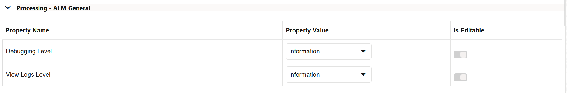

    Processing-ALM General section of Application Preference
    Table 6-16 Processing-ALM General section of Application Preference
    Fields Description
    Debugging Level
    The debugging output level determines the amount of SQL that will be written to the processing log. There are eight levels available:
    1. Trace: Designates finer-grained informational events than the DEBUG.
    2. All: All levels including custom levels.
    3. Error: Designates error events that might still allow the application to continue running.
    4. Information: Designates informational messages that highlight the progress of the application at coarse-grained level.
    5. Debug: Designates fine-grained informational events that are most useful to debug an application.
    6. Fatal: Designates very severe error events that will presumably lead the application to abort.
    7. Warning: Designates informational messages that highlight the progress of the application at coarse-grained level.
    8. Off: The highest possible rank and is intended to turn off logging.
    Note: A log request of level p in a logger with level q is enabled if p >= q. This rule is at the heart of log4j. It assumes that levels are ordered. For the standard levels, we have ALL < DEBUG < INFO < WARN < ERROR < FATAL < OFF.
    View Logs Level
    This shows the severity of the information telling you how important a given log message is. This shows the View level of the Log.

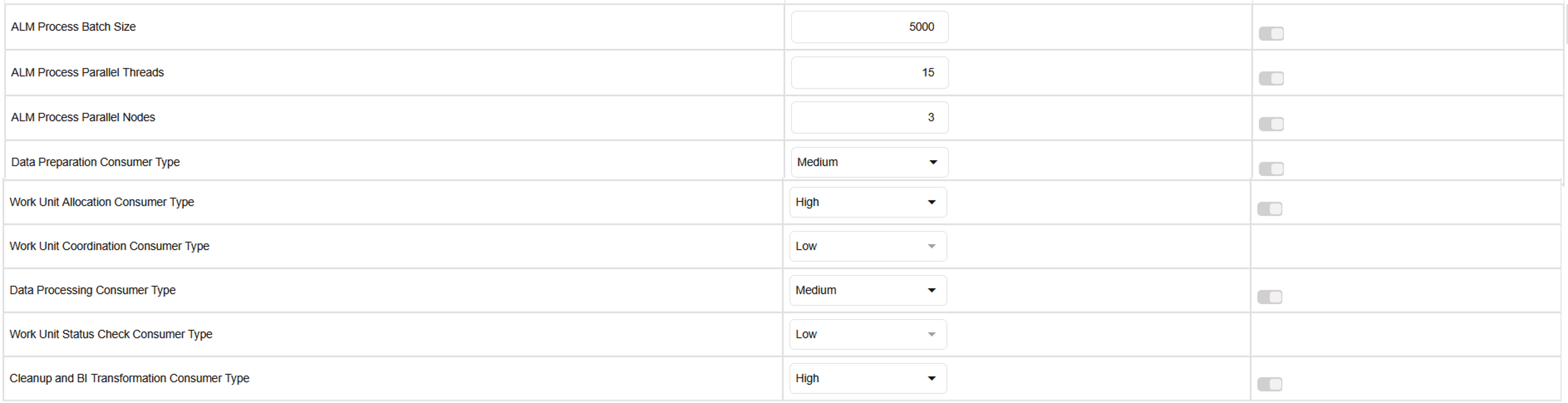

    Figure 6-39 Processing-ALM Process section of Application Preference
    Table 6-17 Processing- ALM Process section of Application Preference
    Fields Description
    ALM Process Batch Size
    Number of Account or Instruments that must be processed in a single batch.
    Default Value of 5000 is seeded by the service, and you can modify it as needed
    ALM Process Parallel Threads
    Number of threads created by the executor for each batch. This is a performance tuning parameter for ALM Cloud Service. This defines how much memory can be used by the different components of the process such as the stack, data and text segments.
    Default Value of 15 is seeded by the service, and you can modify it as needed
    ALM Process Parallel Nodes Number of nodes created by the executor for each batch.
    Default Value of 3 is seeded by the service, and you can modify it as needed
    Data Preparation Consumer Type Shows the Data Preparation Consumer Type as Low, high or Medium. Default value is Low.
    Work Unit Allocation Consumer Type Shows the Work Unit Allocation Consumer Type as Low, high or Medium. Default value is High.
    Work Unit Coordination Consumer Type Shows the Work Unit Coordination Consumer Type as Low, high or Medium. Default value is Low.
    Data Processing Consumer Type Shows the Data Processing Consumer Type as Low, high or Medium. Default value is Medium.
    If you are executing two processes simultaneously, then set this parameter to Medium.
    Work Unit Status Check Consumer Type Shows the Status Check Consumer Type as Low or Medium. Default value is Low.
    Cleanup and BI Transformation Consumer Type Shows the Cleanup Consumer Type as Low, high or Medium. Default value is Medium.
    Caution: These are performance tunning parameters. Do not modify the recommended values of these parameters. To modify these parameters, contact to Oracle Support. For more information, see Autonomous Database Serverless documentation.
    Below example shows that how each parameter gets used.
      10 60 120 240 420 600 1200 3000 6000 12000
    T-shirt Size P Nano Micro XXS XS S M L XL XXL
    ALMCS - ALM Process
    ALM Process Batch Size 50000 50000 50000 50000 50000 100000 100000 100000 100000 100000
    ALM Process Parallel Nodes 2 2 2 2 2 2 4 4 5 5
    ALM Process Parallel Threads 2 2 2 4 4 6 8 8 25 25
    Data Preparation Consumer Type Low Low Low Low Low Low Medium Medium Medium Medium
    Work Unit Allocation Consumer Type High High High High High High High High High High
    Data Processing Consumer Type Medium Medium Medium Medium Medium Medium Medium Medium Medium Medium
    Cleanup and BI Transformation Consumer Type Medium Medium Medium Medium Medium Medium High High High High

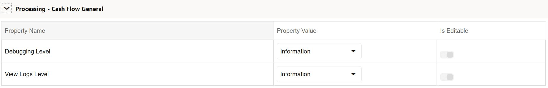

    Figure 6-40 Processing-Cash Flow General section of Application Preference
    Table 6-18 Processing-Cash Flow General section of Application Preference
    Fields Description
    Debugging Level
    2. Error: Designates error events that might still allow the application to continue running.
    3. Information: Designates informational messages that highlight the progress of the application at coarse-grained level.
    4. Debug: Designates fine-grained informational events that are most useful to debug an application.
    5. Fatal: Designates very severe error events that will presumably lead the application to abort.
    6. Warning: Designates informational messages that highlight the progress of the application at coarse-grained level.
    View Logs Level
    This shows the severity of the information telling you how important a given log message is. This shows the View level of the Log. There are three levels available:
    1. Information: Designates informational messages that highlight the progress of the application at coarse-grained level.
    2. Debug: Designates fine-grained informational events that are most useful to debug an application.

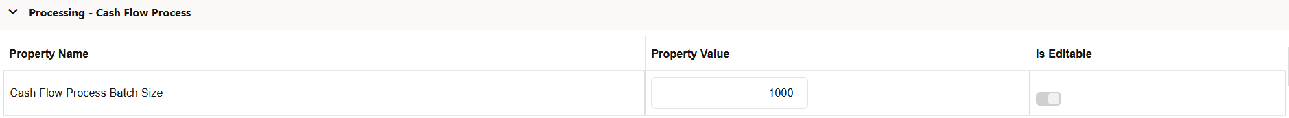

    Figure 6-41 Processing-Cash Flow Process section of Application Preference
    Table 6-19 Processing-Cash Flow Process section of Application Preference
    Fields Description
    Cash Flow Process Batch Size
    Number of Account or Instruments that must be processed in a single batch. This is used by Cash Flow Engine for performance tuning.
    Default Value of 1000 is seeded by the service, and you can modify it as needed
    Below example shows that how each parameter gets used taking 100k records.
    The given "Cash Flow Process Batch Size" values are based on single process execution at a time.
    Cash Flow Process Batch Size = Below Cash Flow Process Batch Size/## no of parallel executions ##
    CFECS - Cash Flow Process
    Cash Flow Process Batch Size 50000 50000 50000 50000 50000 100000 100000 100000 100000 100000

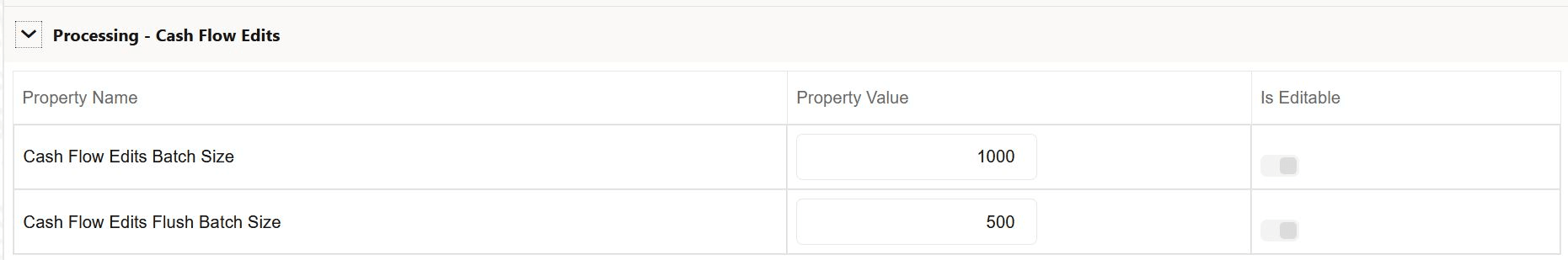

    Figure 6-42 Processing-Cash Flow Edits section of Application Preference
    Table 6-20 Processing-Cash Flow Edits section of Application Preference
    Fields Description
    Cash Flow Edits Batch Size
    Number of Account or Instruments that must be processed in a single batch. This is used by Cash Flow Edits Engine for performance tuning.
    Cash Flow Edits Flush Batch Size
    Number of records that gets saved or updated in a batch during Cash Flow Process execution. This is used by Cash Flow Engine for performance tuning.
    Default Value of 500 is seeded by the service, and you can modify it as needed

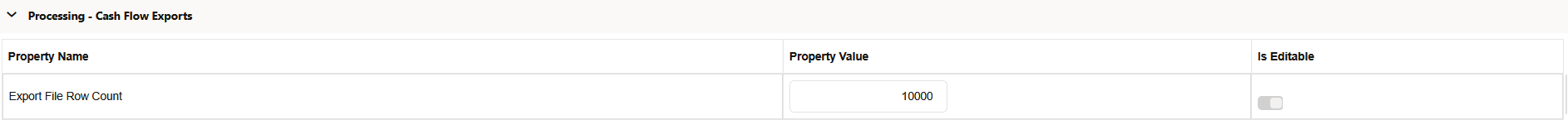

    Figure 6-43 Processing - Export Results
    Table 6-21 Processing - Cash Flow Exports section of Application Preference
    Fields Description
    Export File Row Count
    Number of records to be included in one file when cash flow output is exported from database to Object Storage. You must enter value greater than zero
