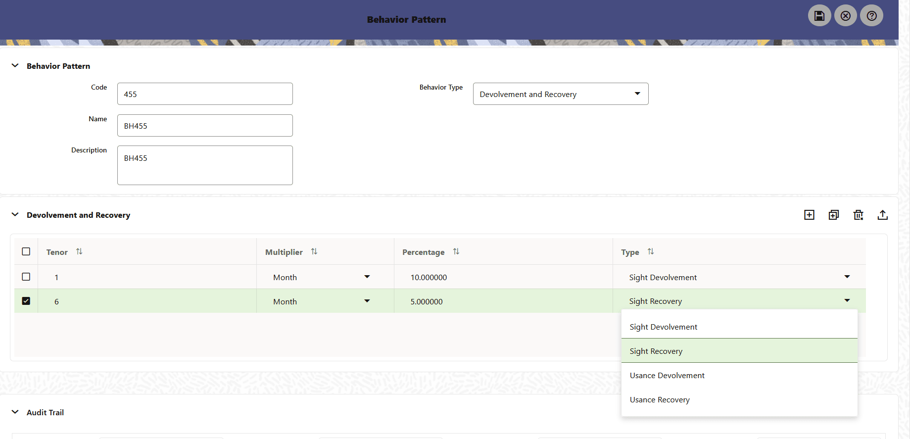

- In the Behavior Pattern Details Page, select Devolvement and Recovery as the Behavior Pattern Type.
- Click the Add icon to open the Non-Performing Behavior Patterns
Summary Page.
Figure 6-51 Behavior Pattern with Type as Devolvement and Recovery
- Enter or select the following details:

- Type: This allows you to classify the Runoff based on the appropriate
type. The options are:
- Sight Devolvement: indicates the Beneficiary is paid as soon as the Paying Bank has determined that all necessary documents are in order. This is the preferred approach.
- Sight Recovery
- Usance Devolvement: Usance: is a period, which can be between 30 and 180 days after the bill of Lading Date.
- Usance Recovery
There is no difference in behavior from a Cash Flow perspective, but the Runoff Amount will be written to a Principal Runoff Financial Element corresponding to the selected Runoff Type.
