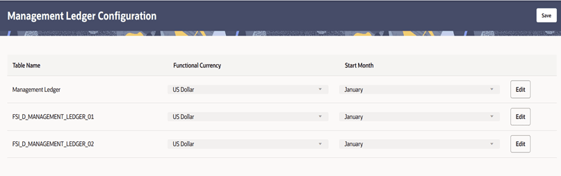

    Figure 6-62 Management Ledger Configuration
    The Management Ledger Configuration screen allows you to input the Management Ledger Configuration for Profitability Management Cloud Service.

    • Table Name: This field displays the logical name of the Management Ledger table for which you want to input the details. The physical name of the Management Ledger table is displayed in a toolkit on mouse-hover over the logical name of the table.
