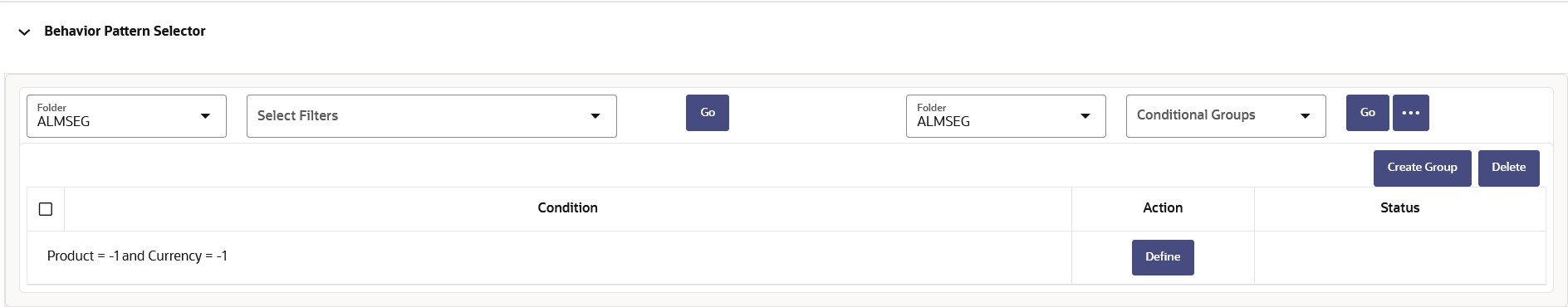

To define conditional assumption, follow these steps:
- Navigate to Conditional Assumptions section.
Figure 6-120 Conditional Assumption
- Select the Filter Folder and Filter, then click Go. The condition is displayed based on selected filter.
- Here, you can select either group of conditions using Conditional
Group or Individual condition using the filter section.

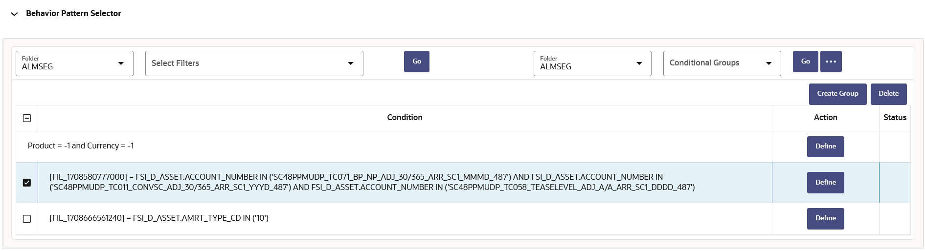

- You can select the conditional groups from the Conditional
Group drop-down. You can create a new condition group using
the Create Group button. To create a new condition
group, follow these steps:
- Select filters using the Filter
drop-down list.
You must select minimum 2 filters to define a condition group. - Select the conditions (filters) using the corresponding check-boxes.
- Click Create Group .

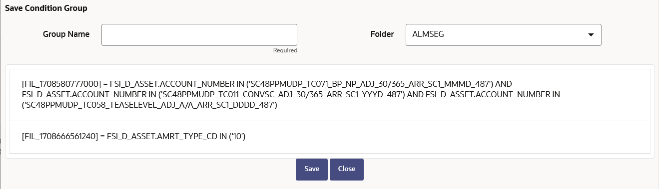

- The Save Condition Group window
is displayed. Provide the Group Name and
select the Folder where you want to save the
condition group. Click Save in
Save Condition Group window. You can use
this saved group from Condition Group
down-down.
Figure 6-121 Condition Group
drop-down list.
- Else, select Individual condition using the corresponding check-box.
- Click Define.
Figure 6-122 Conditional Assumption

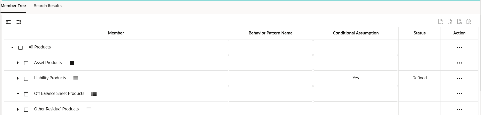

- Click Save. The status of conditional assumption
is also updated in Assumption Browser.
Figure 6-123 Status of Conditional Assumption
