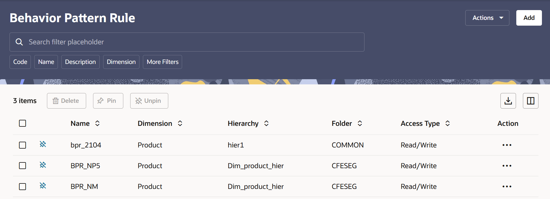

Behavior Pattern Rule Summary
This page is the gateway to all Behavior Pattern Rules and related functionality. You can navigate to other pages relating to Behavior Pattern Rules from this point.
Figure 6-113 Behavior Pattern Rule Summary
Search Behavior Pattern Rule

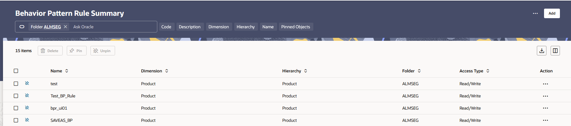

An alternative method to search a Behavior Pattern rule is through the Field Search option. This is an inline wildcard UI search that allows you to enter a search value (such as code, name, etc.) partially or fully. Rows that contain the string you are searching for are fetched and displayed in the Behavior Pattern rule Summary. You can enter the Code, Name, Description, Dimension, Hierarchy, and Folder of the Behavior Pattern Rule and click Search.
The Behavior Pattern rule Summary displays the following information:
Add: Click the Add on the page header to build a new Behavior Pattern rule.
More Actions: Enables you to perform following tasks.
  • Refresh: Retains the selected filters and refreshes the summary page with latest status.
  • Reset: Clears the selected filters and refreshes the summary page.
  • Help: Redirects you to latest documentation.
Delete: Enables you to select and delete one or multiple rules in the table simultaneously.
Pin/Unpin: Enables you to pin/unpin the selected rule.
Export: Enables you to download the summary page details in .CSV format.
Columns: Allows you to view the summary page data using a customized list of columns.
The Behavior Pattern rule table displays the following information:
  • Name: Displays the Behavior Pattern Rule's short name.
  • Dimension: Displays the Dimension the Behavior Pattern Rule belongs to.
  • Hierarchy: Name of Hierarchy that is used to define Behavior Pattern Rule.
  • Folder: Displays the Folder name where the Behavior Pattern Rule is saved.
  • Last Modified By: Displays the Name of the user who last modified the Behavior Pattern Rule.
  • Last Modified Date: Displays the Date and Time when Behavior Pattern Rule was modified last.
  • Access Type: Displays the access type of Rule. It can be Read-Only or Read/Write.
  • Action: Click this icon to view a list of actions that you can perform on the Behavior Pattern rule.
    • View/Edit: Based on the user privilege assigned, you can either only view or edit existing Behavior Pattern rules. To edit a rule, you must have Read/Write privilege.
    • Save As: You can reuse a Behavior Pattern rule by saving it under a new name thus saving time and effort in entering data multiple times; it also leads to reduced data entry errors.
    • Delete: You can delete Behavior Pattern rules that you no longer require. Note that only Behavior Pattern rule owners and those with Read/Write privileges can delete Behavior Pattern rules. A Behavior Pattern rule that has a dependency cannot be deleted. A rule cannot be retrieved after deletion.
    • Dependency Check: You can perform a dependency check to know where a particular Behavior Pattern rule has been used. Before deleting a rule, it is always a good practice to do a dependency check to ensure you are not deleting Behavior Pattern rules that have dependencies. A report of all rules that utilize the selected Behavior Pattern rule is generated.
