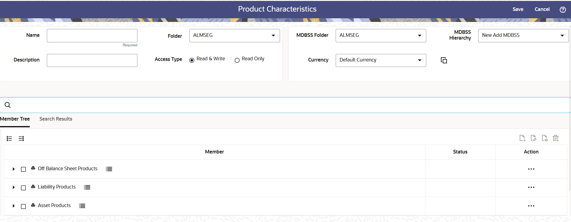

To create a new Product Characteristics Rule, follow these steps:
  1. Click Add icon from the top of the Product Characteristics Summary Page.
  2. Enter the following Details.
    Table 6-38 Create Product Characteristics Rule
    Fields Description
    Name Enter the name of the Product Characteristics Rule.
    Description Enter the description of the Product Characteristics Rule. This is an optional field.
    Folder Select the Folder where the Product Characteristics Rule needs to be saved.
    Access Type Select the Access Type as Read-Only or Read/Write.
    MDBSS Folder Select the MDBSS folder
    Currency Select the currency for Product Characteristics Rule
    MDBSS Hierarchy Select the MDBSS hierarchy
    If any member is a currency in the MDBSS hierarchy (for example, INR) and selected currency is different (for example, USD), then the member and its children nodes can not be defined.
  3. Select MDBSS node(s) from Member Tree tab of Assumption Browser. Assumption Browser has two tabs: Member Tree and Search Results.

  4. Click Add from Assumption Browser section.
  5. Click Save.
