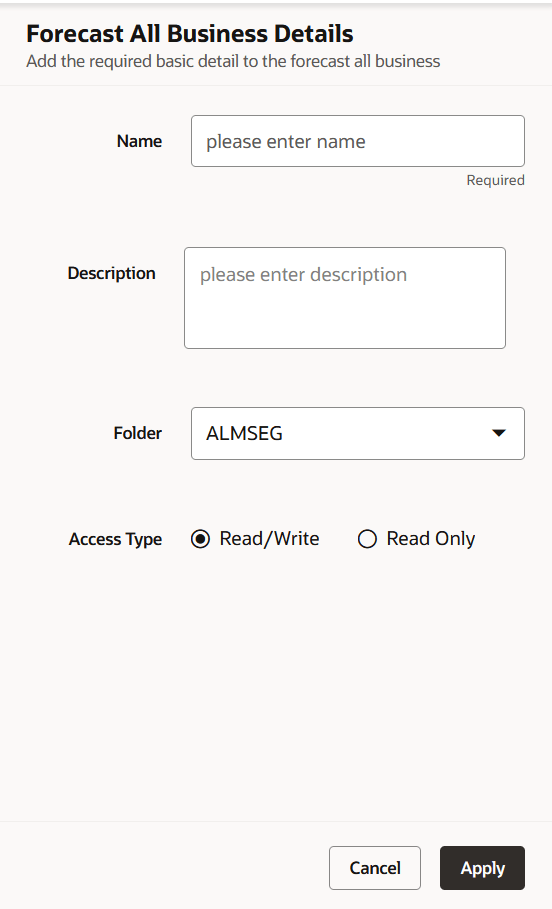

  1. Click Add icon from the top of the Forecast All Business Rule Summary page. The Forecast All Business Details page is displayed.
    Figure 6-187 Forecast All Business Details Page
  2. Enter the following details and click Apply.
    Table 6-47 Create Forecast All Business Rule
    Fields Description
    Name Enter the name of the Forecast All Business Rule.
    Description Enter the description of the Forecast All Business Rule. This is an optional field.
    Folder Select the Folder where the Forecast All Business Rule needs to be saved.
    Access Type Select the Access Type as Read-Only or Read/Write.

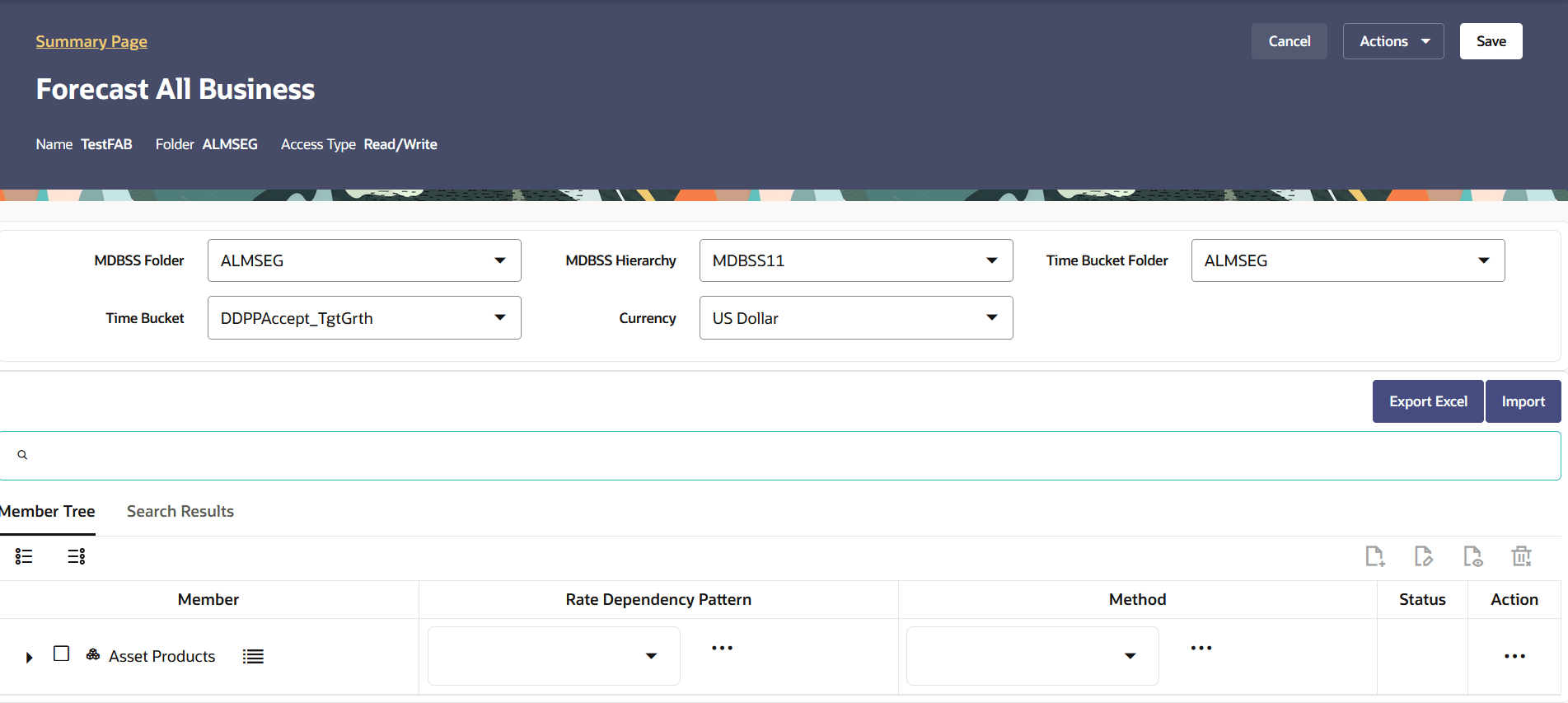

  3. The Forecast All Balance Rule page is displayed.
    Figure 6-188 Forecast All Balance Rule page
    Click Save button to save the draft of Forecast All Business rule.
    You can click on Actions drop-down to view the Detail Info and Audit Info of Forecast All Business rule.

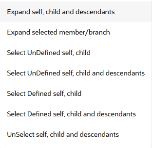

    • Member Tree: Member Tree tab shows the hierarchical structure and allows you to define rules by selecting the node members from the browser. Select Node and Click Menu icon next to it to view the available options.
      Figure 6-190 Member Tree Selection
      Status of node is also displayed in Member Tree section, for example Selected, and so on. To select member hierarchy, following options are available:
      • Expand self, child and descendants: Allows to expand the selected node itself along with its child and descendants.
      • Expand selected member/branch: Allows to expand the selected node
      • Select UnSelect self, child: Allows to unselect the selected node itself along with its child
      • Select UnSelect self, child and descendants: Allows to unselect the selected node itself along with its child and descendants.
      • Select Defined self, child: Allows to select the selected node itself along with its child.
      • Select Defined self, child and descendants: Allows to select the selected node itself along with its child and descendants.
      • UnSelect self, child and descendants: Allows to unselect the selected node itself along with its child and descendants.
