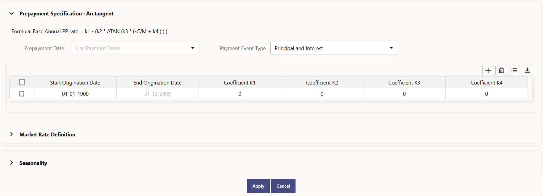

Figure 6-94 Arctangent Calculation Method

  1. Select the Payment Event Type Option.
  2. Select the Start Origination Date using the date picker. Alternatively, you can enter the Start Origination Date in the space provided.
  3. Enter the values for the Arctangent Parameters (columns K1 through K4) for each Start Origina­tion Date in the table. The valid range for each parameter is -99.9999 to 99.9999.
  4. Click Add Another Row.
    You can add as many rows as possible in this table using Add Multiple Row Option. However, you need to enter relevant parameters for each new row.
  5. You can also use the Download Excel Feature to export the Prepayment Rate Information that is displayed on screen, modify, and copy-paste it back in the grid.
