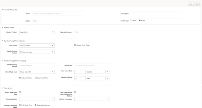

Figure 6-271 Transfer Pricing Rule Definition (Edit Mode)
This screen allows you to modify a selected Transfer Pricing Rule.

        Figure 6-272 Transfer Pricing Rule Definition (Edit Mode)
        This screen allows you to modify an existing Transfr Pricing Rule.
