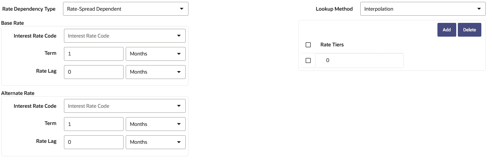

With the Rate-Spread Dependent Relationship, you can input assumptions for different spreads between two indicator interest rates. You define the first indicator interest rate, the Base Interest Rate, as described previously. The second indicator Interest Rate, the Alternate Interest Rate, also requires the selection of an Interest Rate Code, a Term Selection, and a Rate Lag.
Figure 6-219 Rate Dependency Pattern Rule after selecting Rate-Spread Dependent option
The rate spread equals to Alternate Interest Rate - Base Interest Rate

  2. Define the Alternate Interest Rate details. These fields are the same as the Base Rate section.
  3. Select Save.
