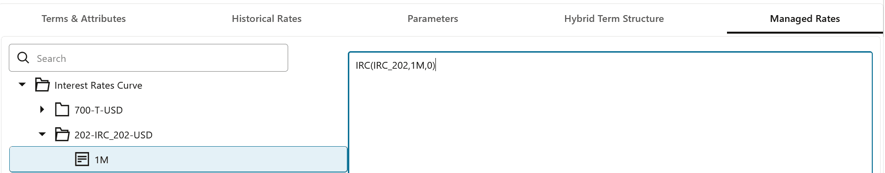

[Object type code].[Object ID].[Tenor if IRC, 0 if anything else].[Place in time]
For example, suppose you want a formula that refers to an interest rate curve's 1 month tenor on a current basis, then its syntax would look something like this:
Figure 6-12 Example of Managed Rate
Here,
[IRC_202] is the IRC code (Object ID)
[1M] is the Term.
[0] is time. This calculates Past, present or future dates/rates with ease for any term/tenor and forecast method definition. The default value is 0. [0] means the now. [-1] refers to back one period. [$] refers to constrained time period.
If the time value falls outside of provided numbers, the Application will refer to the closest matching value. If no value can be retrieved or if the value is null, then the Managed Rate formula will not be evaluated.

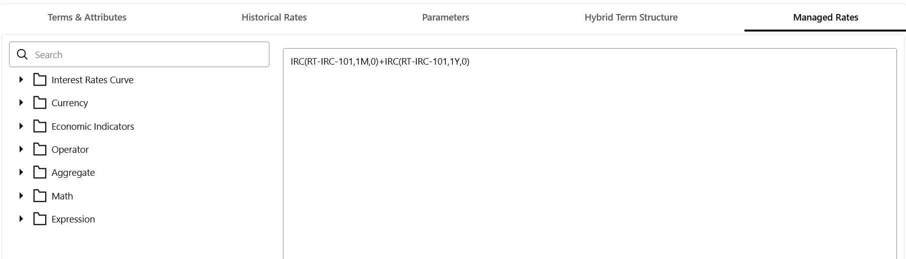

To define Managed Rate, follow these steps:
  1. Select Structure Type as Managed Rates.
  2. Navigate to Managed Rates tab.
    This tab will be active only when Structure Type is selected as Managed Rates.
  3. Select the Function type as Interest Rate Curve, Currency, or Economic Indicator to define a formula.
  4. Double-click the Function code to move it to Formula section.
  5. Update the formula. Use arithmetical operator from Operator to define formula if required.
    Figure 6-13 Formula section
    Formula section
