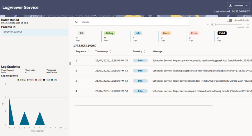

- Click on the Action icon against the Cash Flow Edits Process Name and select Execution Details. The Execution Details window is displayed.
- Click any Execution ID to view the log details. The Log Viewer Window shows the complete details of process along with Batch Run ID Information.
- Click Download to export the details of cash flow edits in csv format. This will help you to understand errors found in instrument data.
