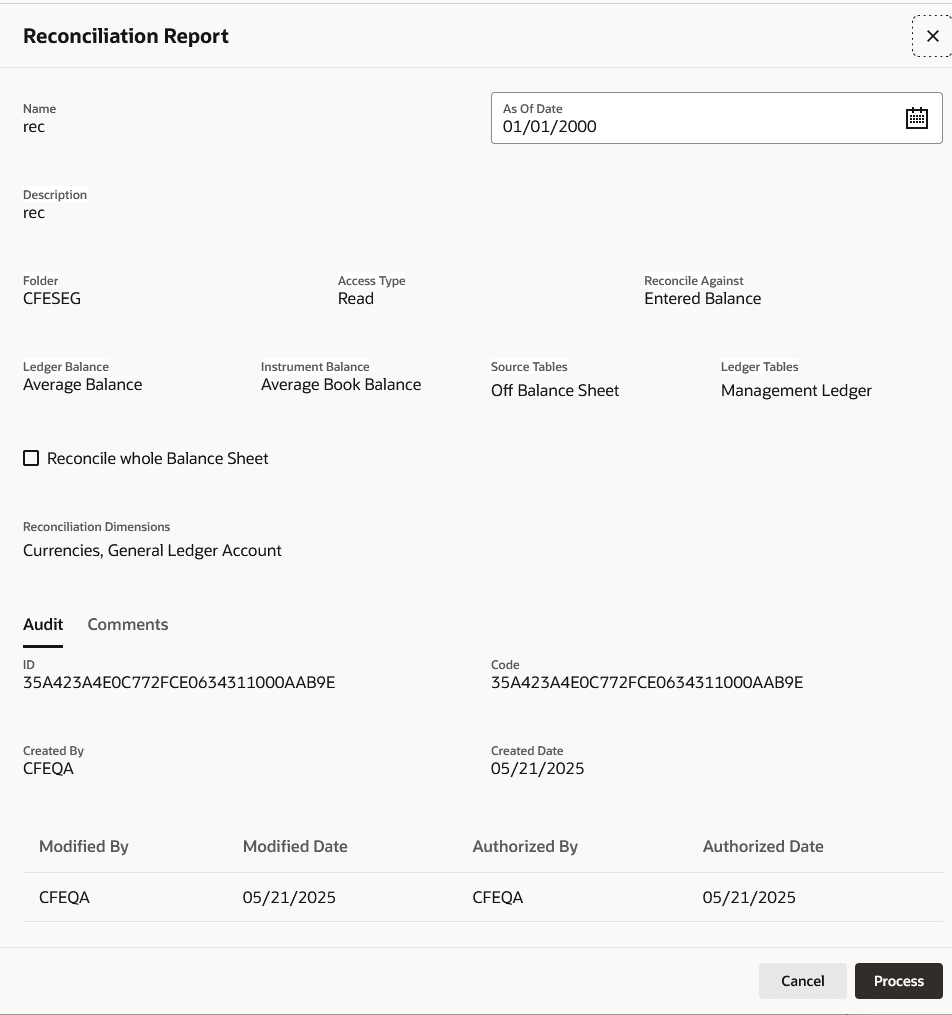

  • Execute: Click this action button and perform the reconciliation as per the selected parameters.
    As-of-Date is a run time parameter, you can choose for which date reconciliation needs to be performed.
    Figure 4-49 Reconciliation Report
    If the Reconcile Whole Balance Sheet checkbox is selected, the system retrieves all available dimension combinations from both the FSI_D_MGT_LEDGER and the selected instrument tables, regardless of whether matching dimension combinations exist between the ledger and the instrument tables.

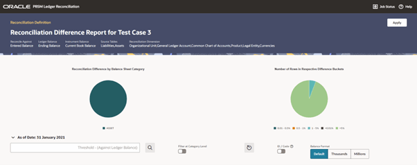

    After clicking Process, the Reconciliation Difference Report will be generated as follows:
    Report starts with the summary across Balance Sheet categories and difference buckets pie charts, which can help you to get an idea about the reconciliation difference in a quick glimpse.
    Figure 4-50 Reconciliation Difference Report

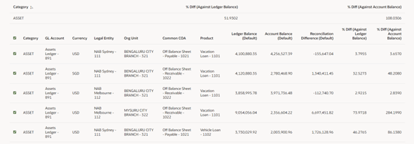

    The detailed report is displayed as follows, where you can filter out insignificant difference using ‘Threshold Percentage’, also threshold can be applied at each row level or for whole Balance Sheet category level. If threshold is applied at Balance Sheet category level, all the rows that belong to the Balance Sheet category which is less than given percentage will be hidden from the Reconciliation Difference Report. A download button allows you to download the Reconciliation Report.
    You can select Filter at Category Level toggle switch to apply threshold at ‘consolidated difference reports’, which is at balance sheet category level OR can directly apply the threshold to each difference row, which is available at the unique combination of selected key dimensions.
    You can select the ID / Code toggle switch to see the CD data. By default, the toggle switch displays the ID data.
    You can also change the unit of balance to thousands or millions.
    You can see difference in both percentage and absolute format.
    Figure 4-51 Differences in Percentage and Absolute Formats

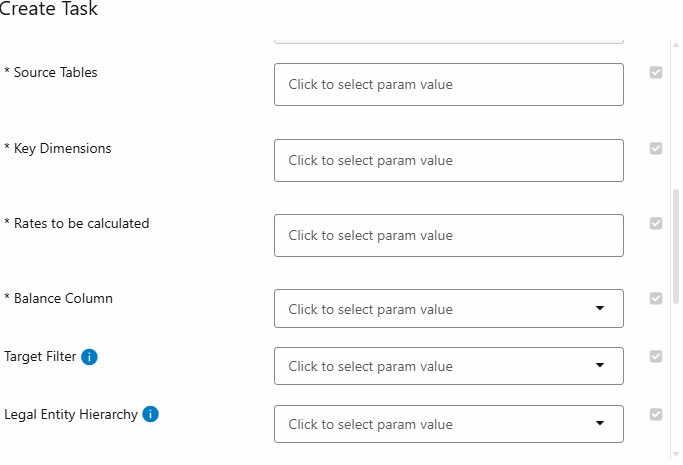

  • Weighted Rate Calculations for Plug Entires: A new task component Weighted Rate Calculations for Plug Entires is added. You can use this component to compute balance-weighted average FTP rates for plug entries. When this component is configured, the system can calculate FTP rates based on the weighted average of the underlying accounts in the selected source instrument tables.
    The following configurations are available:
    • Source Tables: This option specifies the instrument tables from which the system pulls the underlying accounts for the weighted rate calculation, and the available values include Asset Instruments, Liability Instruments, and Off-Balance Sheet Instruments.
    • Key Dimensions: This option defines the dimensional attributes used to group the underlying accounts for the weighted rate computation, and the available values include Product, Common Chart of Accounts, or any other enabled key dimension.
    • Rates to be Calculated: This option indicates the types of FTP rates that the system should compute using the weighted methodology, and the available values include Transfer Rate, All-In Transfer Price Rate, and any other enabled rate types.
    • Balance Column: This option identifies the balance used as the weighting factor in the calculation, and the available values may include Average Book Balance, Current Par Balance or Current Book Balance and so on.
    • Target Filter: This filter enables the users to select the target plug entries for which the rate must be calculated.
    • Legal Entity Hierarchy: This option helps to select the Legal Entity Hierarchy.
    • Legal Entity: This option helps to select the legal entity nodes in the chosen Legal Entity Hierarchy.
    Figure 4-53 Weighted Rate Calculations for Plug Entires
    The image shows the configuration panel for Weighted Average FTP Rates for Plug Entries, with fields for selecting source tables, key dimensions, rate types, balance column, filters, and legal entity details.
