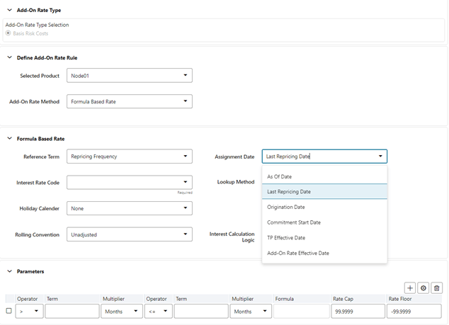

You can create your Reference Term ranges and assign a particular Formula Based Rate to all instruments with a Reference Term falling within the specified range.
With this method, you also specify the Interest Rate Code and define an Assignment Date for the Rate Lookup. The Interest Rate Code can be any IRC defined within Rate Management, but will commonly be a Hybrid IRC defined as a Spread Curve (for example, Curve A – Curve B).
Figure 6-283 Add-on Rule Details - Formula Based Rate (Assignment Date)
Assignment Date selections include:
  • As-of-Date
  • Last Repricing Date
  • Origination Date
  • TP Effective Date
  • Adjustment Effective Date
  • Commitment Start Date
Each term range additionally allows users to input a Rate Cap and a Rate Floor. These boundaries will only apply to the 'Formula Based Method' and 'Use TP Method from TP Rule' based add-On Rates. These are optional inputs. This input limits the Max or Min rate regardless of the rate passed by the Formula/TP Rule. Sometimes, there may be major external events that cause a short-term spike in rates and certain accounts may be negatively impacted as a result. Applying a rate cap (or floor) allows business users to limit these spikes. Ensure that the rate floor value is always less than or equal to the rate cap value.

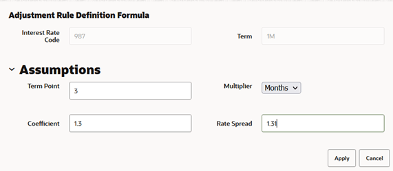

The formula definition is comprised of the following components.
  • Term Point: This allows you to associate a specific term point from the IRC to each Term Range.
  • Coefficient: This allows you to define a multiplier that is applied to the selected rate.
  • Rate Spread: This allows you to define an incremental rate spread to be included on top of the IRC Rate.
Figure 6-284 Add-On rate Rule Definition Formula
The resulting formula for add-on rate: (Term Point Rate * Coefficient) + Spread
Figure 6-285 Formula Rate Parameters
