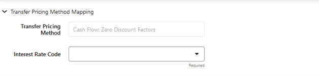

Figure 6-252 Cash Flow: Zero Discount Factors
