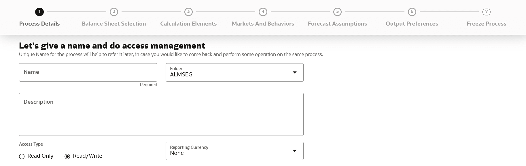

  1. Navigate to the Dynamic Deterministic Process Summary page.
  2. Click Add . The Create Dynamic Deterministic Process page is displayed.
  3. Enter the details in the Process Details section.
    Figure 6-318 Dynamic Deterministic Process
    Table 6-94 List of process details used for Creating Dynamic Deterministic Process
    Parameter Description
    Name Enter the name of the Dynamic Deterministic Process.
    Folder Select the Folder where the Dynamic Deterministic Process needs to be saved.
    Description Enter the description of the Dynamic Deterministic Process.
    Access Type Select the Access Type as Read Only or Read/Write.
    Reporting Currency Select the currency for consolidation of results
    Currency Provider This field will be active once you select Reporting Currency. Select the Currency Provider as Default.

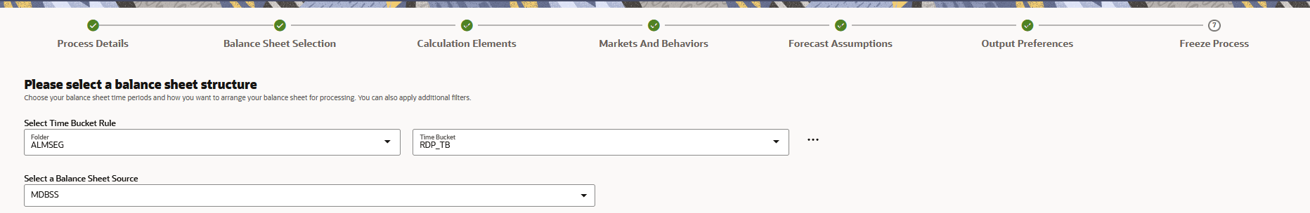

  4. Click Apply to navigate to the Balance Sheet Selection section.
    Figure 6-319 Balance Sheet Selection
  5. Enter the Balance Sheet Structure details as shown in the following table:
    Table 6-95 List of Balance Sheet Structure details used for Creating Dynamic Deterministic Process
    Time Bucket Rule Folder Select the Folder from which you want to apply Time Bucket Rule.
    Time Bucket Rule Select the time horizon/aggregation for process.
    Also, following options are available when you click Action button next to Time Bucket field.
    Figure 6-320 Time Bucket
    Time Bucket
    Balance Sheet Source Select the Balance Sheet Source from Balance Sheet Source drop-down list.
    After selecting the Balance Sheet Source, Multi-Dimentional Balance Sheet Structure (MDBSS) details block is activated.

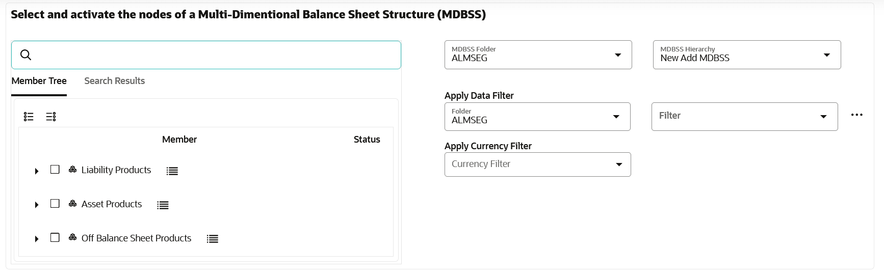

    Figure 6-321 MDBSS Details
    MDBSS Details
    Enter the Data Source details of Balance Sheet.
    Table 6-96 Data Source details used for Creating Dynamic Deterministic Process
    Member Tree This shows the hierarchical structure and allows you to define rules by selecting the node members from the browser. Select Node and Click Menu icon next to it to view the available options.

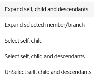

    Figure 6-322 Member Tree Selection
    Status of node is also displayed in Member Tree section, for example Selected, and so on. To select member hierarchy, following options are available:
    • Expand self, child and descendants: Allows to expand the selected node itself along with its child and descendants.
    • Expand selected member/branch: Allows to expand the selected node
    • Select self, child: Allows to select the selected node itself along with its child.
    • Select self, child and descendants: Allows to select the selected node itself along with its child and descendants.
    • UnSelect self, child and descendants: Allows to unselect the selected node itself along with its child and descendants.

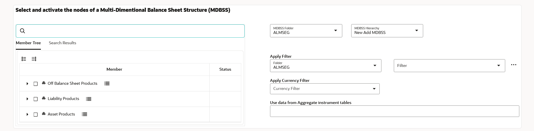

    Assumption Browser Select the Product from Assumption Browser and click Add under Action option.
    MDBSS Folder Select the MDBSS folder
    MDBSS Hierarchy Select the MDBSS hierarchy
    Data Filter Folder Select the Folder from which you want to apply Data Filter.
    Data Filter This field allows you to select a subset of data for processing by selecting a filter. You can select a filter that was previously created, or define a new filter on the fly.
    Data filter defined on PORTFOLIO table only can be used in Balance Sheet selection.
    Currency Filter Optionally, apply a currency filter on the selected data.
    Use data from Aggregate Instrument Tables Select Asset Aggregate or Liability Aggregate table type which needs to be included in process. You can use selected aggregate table(s) to construct instrument data view for processing. If this field is blank, then process will use standard tables.

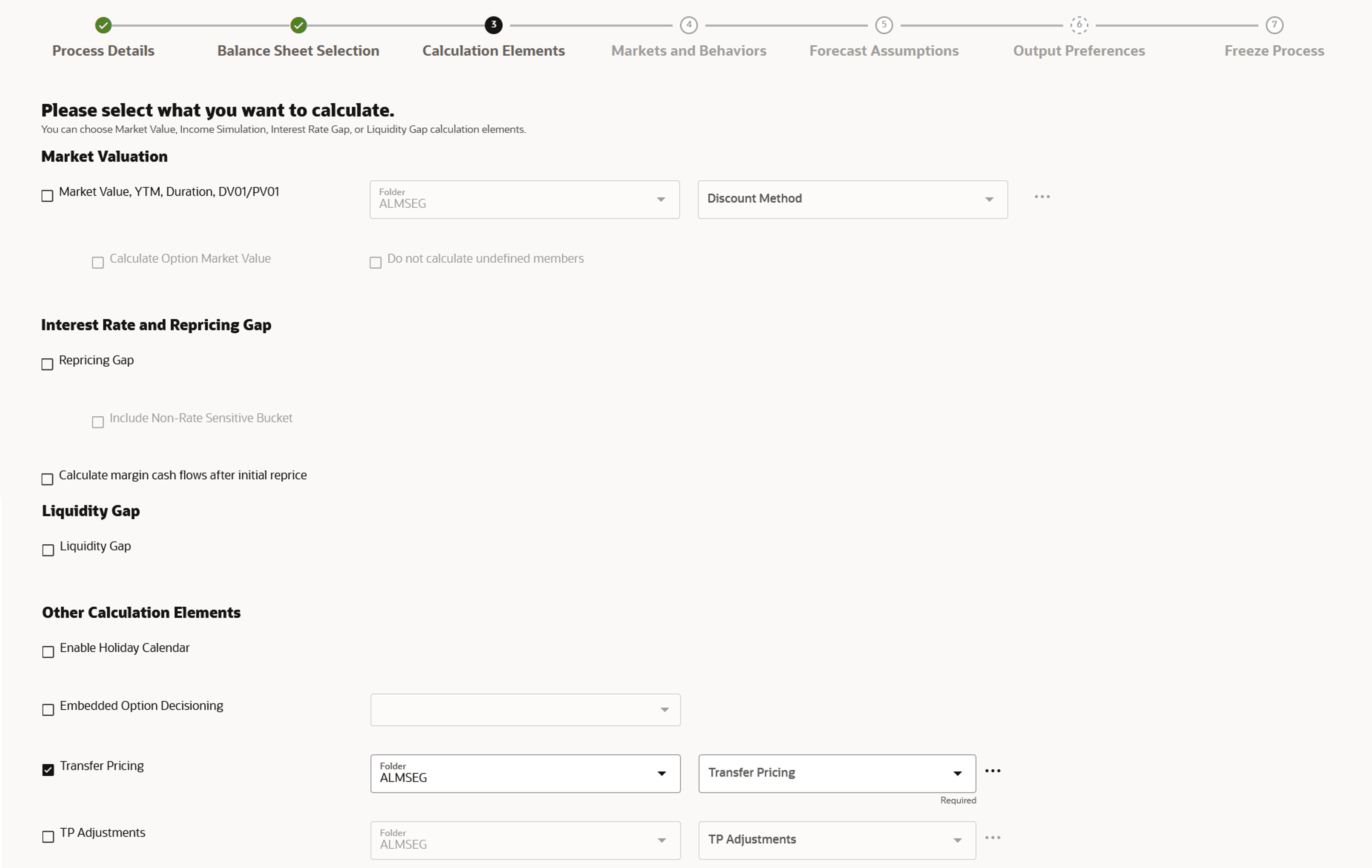

  6. Click Apply to navigate to the Calculation Elements section.
    Figure 6-325 Calculation Elements
  7. Enter the Calculation Elements details as shown in the following table:
    Table 6-97 List of Calculation Elements details used for Creating Dynamic Deterministic Process
    Market Valuation Select the Market Value, YTM, Duration, DV01/PV01 option if you want to perform present value (MV) calculations. Discount method is required. You can select from predefined rules, or create one on the fly.
    Discount Method Folder Select the folder from where discount rules are saved.
    Discount Method Select Discount Method you want to be applied to the process. See Discount Method section to set up the Discount Method Rules.
    Also, following options are available when you click Action button next to Discount Method field.
    Figure 6-326 Discount Method
    Discount Method
    Calculate Option Market Value The Calculate Option Market Value option is used to calculate the Market Valuation (MV) for certain embedded and stand-alone (bare) options. Supported embedded options are Calls, Puts, Caps (caplets) and Floors (floorlets). This option will be enabled only if Market Value, YTM, Duration, DV01/PV01 option is also selected.
    For example, When Calculate Option Market Value check-box is selected and RATE_CAP_LIFE has data filled (that is, holds a non-null value greater than 0), then Embedded CAP Option MV will be calculated.
    When Calculate Option Market Value check box is selected and RATE_FLOOR_LIFE has data filled (that is, it is non-null value greater than 0 or it is less than RATE_CAP_LIFE and RATE_CAP_LIFE is greater than 0), then Embedded FLOOR Option MV will be calculated.
    Include Margin for Adjustable Rate Instruments When the Calculate Option Market Value option is selected, you can include instrument net margin in the forward rate amount for Black valuation. Adjustable rate instruments only and margin type must be Rate.
    Do not Calculate undefined members Enable this option, if undefined members are not required in calculation.
    Repricing Gap Select Repricing Gap check-box if you want to include Interest Rate gap risk measures. Note, this requires a time bucket with IR Gap buckets defined.
    Include Non- Rate Sensitive Bucket
    Include Non Rate Sensitive Bucket check-box gets enabled when ‘Repricing Gap’ is selected. The Attribute of product dimension ‘Interest Rate Sensitivity Category’ identifies products as Interest Rate sensitive or Non Interest Rate sensitive. Once ‘Include Non Rate Sensitive Bucket’ is enabled, reprice gap output of Products which are mapped as Non Interest Rate sensitive, would move into Non Interest Rate Sensitive bucket.
    For more information on Non Interest Rate Sensitive Bucket, see Time Buckets. If ‘Include Non Rate Sensitive Bucket’ is not enabled, engine will ignore ‘Interest Rate Sensitivity Category’ product attribute, and would treat all products as Interest Rate Sensitive. Reprice Gap output would move into respective Reprice Gap buckets.
    Calculate Margin Cash Flow After Initial Reprice If 'Calculate Margin cashflows as After Initial Reprice' check-box is enabled, the engine will use the margin of adjustable rate instruments to continue generating interest cash flows after a gap repricing event up until total runoff occurs.
    Liquidity Gap Select the Liquidity Gap if you want to include liquidity gap risk measures. Note, this requires a time bucket with LR gap buckets defined.
    Enable Holiday Calendar Enable the Holiday Calendar cash flow dates falling on a holiday to adjust as per defined conventions. Holiday calendar criteria is defined on the instruments.

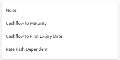

    Embedded Option Decisioning If your processed data contains fixed rate bonds with embedded options, you can select the behavior of the option to force it to maturity of the instrument, force it to first option expiry date, or let it be rate path dependent.
    This drop-down has following options:
    Figure 6-327 Embedded Option Decisioning

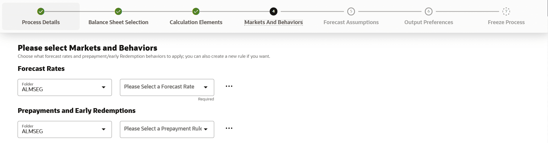

  8. Click Apply to navigate to the Markets and Behaviors section.
    Figure 6-330 Markets and Behaviors
  9. Enter the Markets and Behaviors details as shown in the following table:
    Table 6-98 List of Market and Behavior details used for Creating Dynamic Deterministic Process
    Forecast Rates Select the Folder and Forecast Rates Rule you want to be applied to the process. See Forecast Rates to define rate scenarios. You can select a Forecast Rates Rule that was previously created, or define a new rule on the fly.
    Figure 6-331 Forecast Rates
    Forecast Rates
    Prepayment Rules and Early Redemptions Select the Folder and Prepayment Rule you want to be applied during cash flow calculation. See Prepayment Methods to set up Prepayment Methods. This is an optional step. You can select a Prepayment Rule that was previously created, or define a new rule on the fly.
    Figure 6-332 Prepayment Rules
    Prepayment Rules

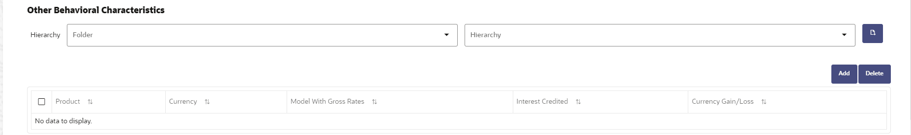

  10. Enter the following details in Other Behavioral Characteristics sub-section of Market and Behaviors section.
    Figure 6-333 Other Behavioral Characteristics
    Table 6-99 Product Characteristics details used for Creating Dynamic Deterministic Process
    Product Hierarchy Folder
    You can specify additional processing parameters at a product-currency level.
    Select the Folder from the Product Hierarchy Folder list.
    Product Hierarchy
    Select the Product Hierarchy on which you want to specify the parameters. To add a Product Hierarchy, follow these steps:
    1. Click Open Hierarchy Browser button next to the Hierarchy field.
    2. Select one or more products using the corresponding check-box and click Done.
    Figure 6-334 Product details
    Product details
  11. After clicking Add, the list of products is displayed with the following details:
    Table 6-100 Product details used for Creating Dynamic Deterministic Process
    Product Shows the selected product details.
    Currency Shows the currency of the selected product.
    Interest Credited Yes or No status of Interest Credited. This option shows the interest payments to be capitalized as principal on simple or non-amortizing instruments.
    Model With Gross Rates If the institution has outsourced loan serving rights for some of the assets (most typically mortgages), the rates paid by customers on those assets (gross rates) are greater than the rates received by the bank (net rates). For these instruments, both a net and gross rate is calculated within the cash flow engine and both gross and net rate financial elements are the output. The gross rate is used for prepayment and amortization calculations. The net rate is used for income simulation and the calculation of retained earnings in the auto-balancing process.
    Currency Gain/Loss If you are consolidating to a reporting currency, select one of the following methods
    • Historical
    • Temporal
    • Currency Rate
    See Currency Gain Loss Basis for more details.

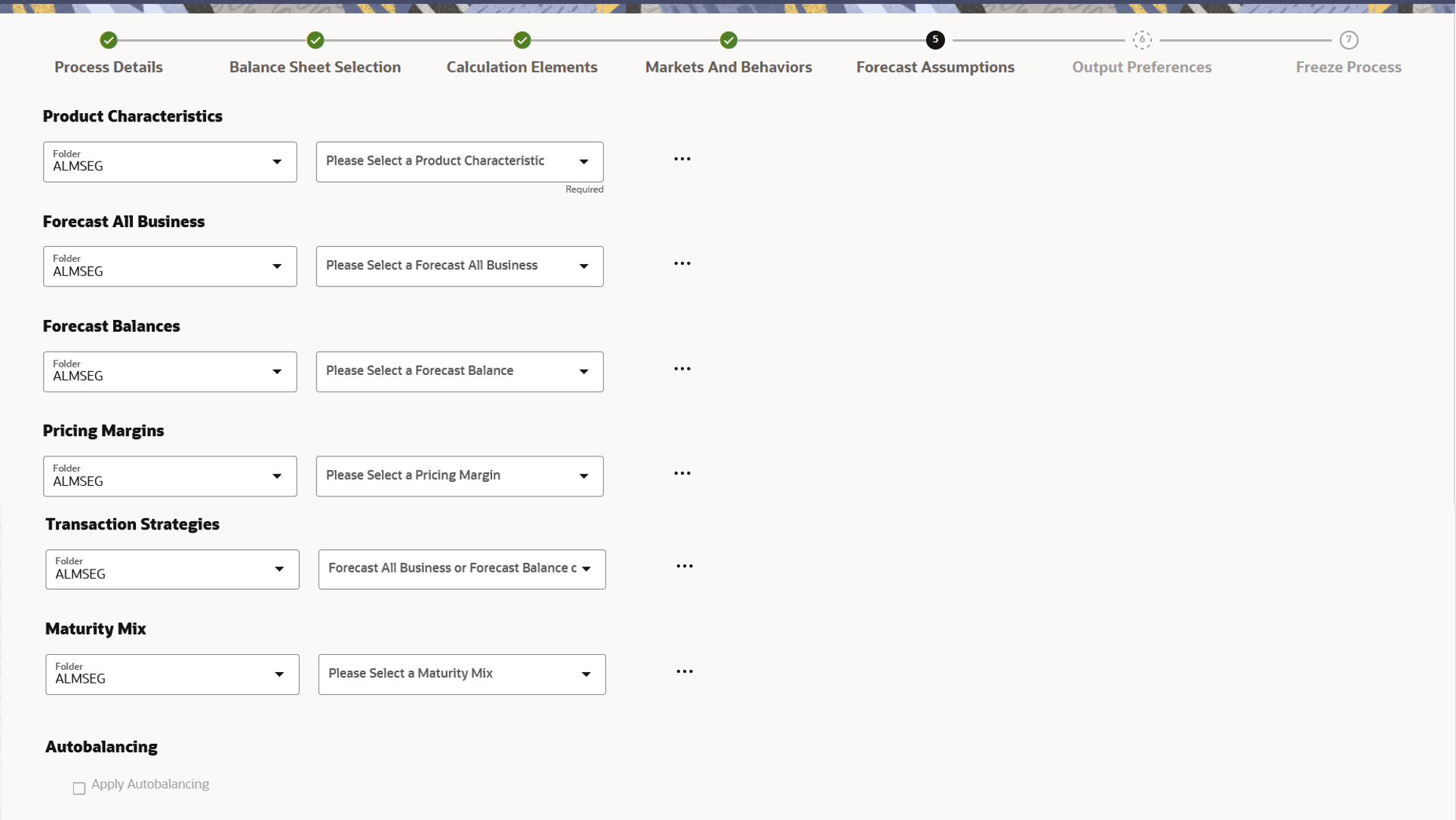

  12. Click Apply to navigate to the Forecast Assumptions section.
    Figure 6-335 Forecast Assumptions
  13. Enter the Forecast Assumptions details as shown in the following table:
    Table 6-101 List of Forecast Assumptions details used for Creating Dynamic Deterministic Process
    Product Characteristics Select the Folder and Product Characteristics Rule you want to be applied to the process. See Product Characteristics to define the Product Characteristics rules.
    Figure 6-336 Product Characteristics
    Forecast All Business Select the Folder and Forecast All Business Rule you want to be applied to the process. See Forecast All Business to define the Forecast All Business rules.
    Figure 6-337 Forecast All Business
    If the Forecast All Business rule is selected, then Forecast Balances and Pricing Margins rules cannot be selected. The Forecast All Business rule is mutually exclusive with the Forecast Balances and Pricing Margins rules.
    Forecast Balances Select the Folder and Forecast Balance Rule you want to be applied to the process. See Forecast Balances to define the Forecast Balance rules.
    Figure 6-338 Forecast Balances
    Forecast Balances
    If the Forecast All Business rule is selected, the Forecast Balances rule cannot be selected. The Forecast All Business rule is mutually exclusive with the Forecast Balances and Pricing Margins rules.
    Pricing Margins Select the Folder and Pricing Margin Rule you want to be applied to the process. See Pricing Margins to define the Pricing Margin rules.
    Figure 6-339 Pricing Margins
    Pricing Margins
    If the Forecast All Business rule is selected, then Pricing Margin rule cannot be selected. The Forecast All Business rule is mutually exclusive with the Forecast Balances and Pricing Margins rules.
    Transaction Strategies Select the Folder and Transaction Strategy Rule you want to be applied to the process. See Transaction Strategies to define the Transaction Strategy rules.
    Figure 6-340 Transaction Strategies
    Maturity Mix Select the Folder and Maturity Mix Rule you want to be applied to the process. See Maturity Mix to define the Maturity Mix rules.
    Figure 6-341 Maturity Mix
    Maturity Mix
    Autobalancing Select Apply Autobalancing check-box to enable the Autobalancing.
    Use autobalancing to maintain a balanced balance sheet, and generate retained earnings. Product leaf members used during the autobalancing process must be defined within your Application Preferences, including: Assets Liabilities Retained .
    If you do not completely define the required autobalancing leaves in Application Preferences, an error message is generated during processing.

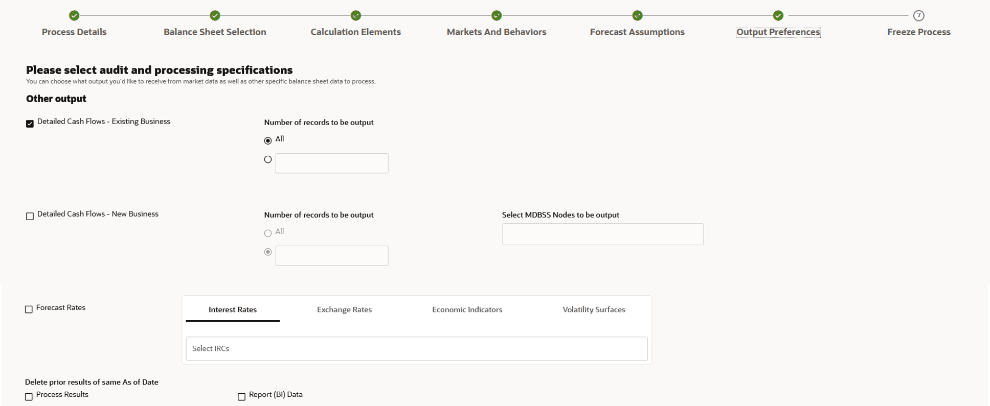

  14. Click Apply to navigate to the Output Preferences section.
    Figure 6-342 Output Preferences
    Output Preferences
  15. Enter the Output Preferences details shown in the following table.
    Table 6-102 List of Output Preferences details used for Creating Dynamic Deterministic Process
    Detailed Cash Flow - Existing Business
    Check the box to record the instrument detail cash flows occurring for the desired number of records processed. For each record, daily cashflow and market value results are written to the FSI_ALM_CASHFLOW_OUTPUT_HIST and FSI_ALM_CASHFLOW_DYN_MV_OUTPUT_HIST tables.
    Enter desired number of Records in the box or select all records to be output.
    The number of records output directly impact processing time. It is recommended to use this as an Audit function only, with few records chosen.
    Detailed Cash Flow - New Business
    Enter the desired number of Records in the box or select all records to be output.
    The number of records output directly impact processing time. It is recommended to use this as an audit function only, with few records chosen.
    Youcan also select the specific MDBSS node to record the instrument detail cash flows occurring for the desired number of records processed from the Select MDBSS Nodes to be output list. The number of new business records created depends on new business definition and can range from few to many for a specific MDBSS node.
    For example, forecast balance method of Rollover with multiple Maturity Mix Terms, defined for many modeling time buckets, can createmany number of new business records, whereas for forecast balance method of New Add with single Maturity Mix Term, defined for few modeling time bucket, will create few business records.
    Forecast Interest Rates Select the Interest Rate Curves for which you want the engine to write forecasted interest rates in the database table.
    Forecast Exchange Rate Select the Exchange Rates for which you want the engine to write forecasted exchange rates in the database table.
    Forecast Economic Indicators Select the Economic Indicators for which you want the engine to write forecasted interest rates in the database table.
    Volatility Surface Select the Volatility Surfaces for which you want the engine to write forecasted Volatility Surface in the database table.
    Delete prior results of same As of Date
    • Process Results: If this check-box is selected, then engine removes the results of previous process execution ID and As of Date. Engine fetches all the details of the same Process ID and As Of Date from the tables. Process history tables keep track of execution id's whose data has been deleted.
    • Report (BI) Data: If this check-box is selected, then engine moves the results of previous process to BI report before removing the results of previous process execution ID and As of Date.

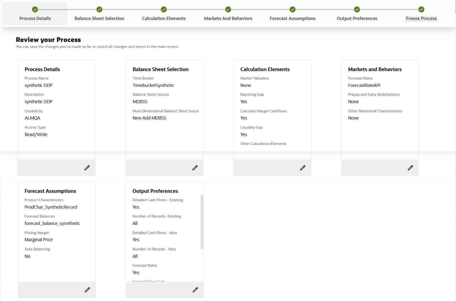

  16. Click Apply to navigate to the Freeze Process section.
    Figure 6-343 Freeze Process
    Freeze Process
  17. Verify the changes and click Save.
