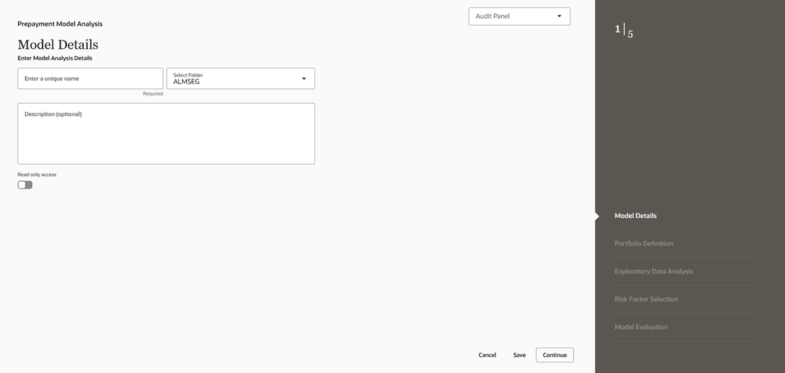

Step 1: Model Details
  1. From Prepayment Model Analysis tab, click Start. The Model Details page is displayed.
    Figure 6-350 Model Details
    Model Details
  2. Enter the following details:
    • Model Name: Name of Process. The Data Creation Process Name should be unique. Any special characters are not applicable.
    • Folder: Folder Name where you want to save the process.
    • Description: Description of Process. The maximum limit of this field is 300 characters. You can enter special characters in this field.
    • Read only Access: Select this option, if you want to make the process Readonly.
  3. Click Continue.

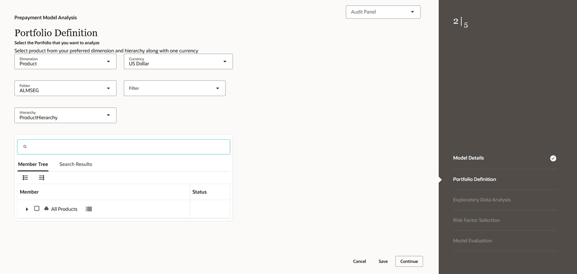

  1. Navigate to the Portfolio Definition section. The Portfolio Definition window is displayed to set Portfolio.
    Figure 6-351 Portfolio Definition
    • Dimension:Select the Dimension.
    • Currency: Select the Currency. The Currency drop-down displays the list of active currencies.
    • Folder: Select the Folder from which you want to pick the Hierarchy.
    • Filter: Select the Filter.
    • Hierarchy: You can specify some processing parameters at product-currency combination. Hierarchies in selected Folder will be listed and you can select one from the available list of hierarchies.
    • Select Product(s) from Member Tree of Assumption Browser. The Assumption Browser has following two tabs: Member Tree and Search Results

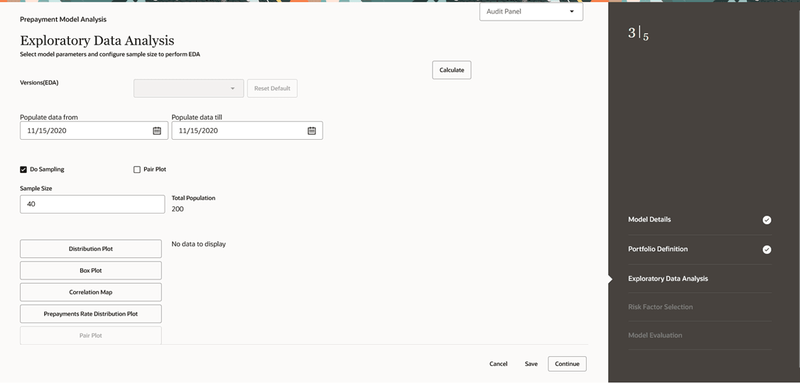

Step 3: Exploratory Data Analysis
  1. Navigate to the Exploratory Data Analysis section. The Exploratory Data Analysis window is displayed to define Exploratory Data Analysis Parameter. This window is used to perform EDA calculations.
    Figure 6-352 Exploratory Data Analysis
    • Sample Size Model Population (As of Date Range):Sample size of dataset for EDA You can define a date range within which one wants to use data for model creation as model population. By Default, Date range would be populated as below: End Date: Max (As of Date) available in Model input Table Start Date: Max [min (As of Date), End Date – 10 Years]
    • Do Sampling Sample Size (Multiplier) :Select this option to create model based on a data Sample rather than the whole population. By default, Do Sampling is enabled. This would enhance performance due to lesser number of records considered for modelling, without degrading model quality. After selecting sample size for EDA, you can select multiplier value. This indicates sample size required for model creation. For example, if 1000, records are selected as sample size for EDA, and multiplier is 6, then a minimum of 1000*6 = 6000 records would be required for model creation. Note: This checkbox is enabled only if Do Sampling checkbox is selected.
      This window gives complete information about all the risk factors along with prepayment rates. It helps you do decide what all factors could influence the customer’s prepayment behavior and would be best for model building. You can hover over any graph and zoom in to enhance the visibility of the graph. Click Model Summary to navigate back to the Model Summary window after saving all inputs/EDA graphs defined/generated till this point. Click Re-Calculate if you want to change the sample size and redo the EDA again. Change the sample size and click Re-Calculate. If you have performed EDA multiple times (for example, three versions V1, V2, V3.), then use Versions (EDA) to view them. For example, when you are on the EDA screen and performing the EDA 3rd time, but still want to go with the 2nd EDA version, then select that version and subsequent processing would be based on V2. If you have run the EDA only once, then this drop-down will not be available. When you hover over Sample size for EDA, it displays Default value (callout) as Default Value is 5000.
      Click Pair Plot to generate Pair Plot/Grid along with other EDA graphs. Pair Plot/Grid is a detailed graph, that can further slow down the processing. So you can explicitly select the pair plot checkbox and click on calculate to perform the EDA.
  3. Click Continue.

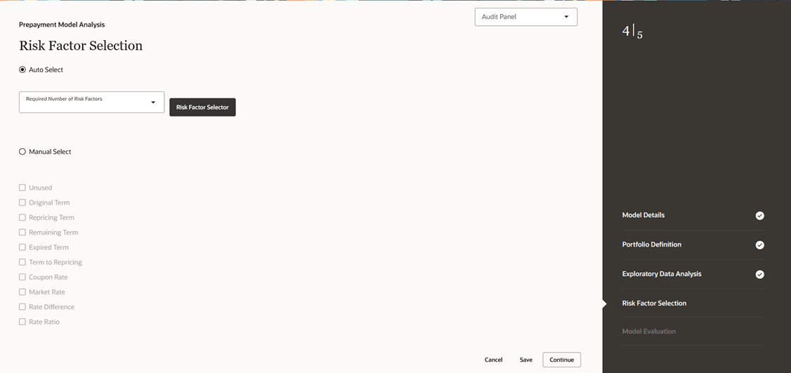

Step 4: Risk Factor Selection
  1. Navigate to Risk Factor Selection section. By default, all the risk factors will be disabled.
    Figure 6-353 Risk Factor Selection

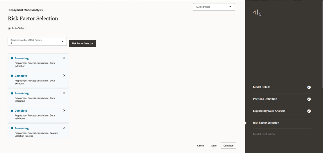

  2. Select the Risk Factor as Manual or Auto.
    Manual Select: When you change the risk factor selection mode to ‘Manual Select’, then all the risk factors would be available for selection; maximum 3 factors can be selected after that all the risk factors would be disabled again.
    Auto Select: When you are in 'Auto Select' mode, System would perform required calculations, corelation/collinearity analysis in the backend based on the required number of risk factors (Maximum 3), System would auto-select the best representative set of risk factors as per the input data.
    Click Risk Factor Selector button.
    Figure 6-354 Risk Factor Selector
    If you want to change sample size and re-calculate EDA again, click Exploratory Data Analysis step and perform EDA with updated sample size. Again, the process starts from that step onwards, and updated EDA plots/graphs would be saved for the model.
  3. Click Continue.

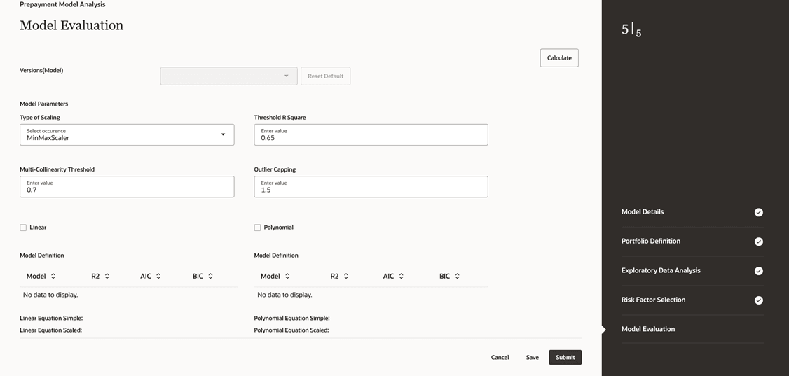

Step 5: Model Evaluation Section
  1. Navigate to Model Evaluation section.
    Figure 6-355 Model Evaluation Section

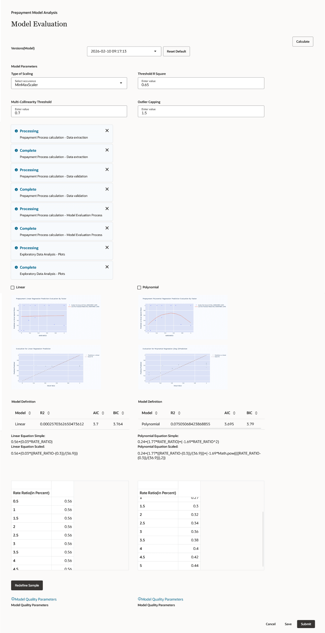

    Click Calculate to view all the evaluation parameters and quality plots.
    Figure 6-356 Calculating Model Evaluation
    Click Calculate again if you are not satisfied with the model quality to change the model parameters and revise the model definition. You can zoom the graph to enhance visibility. If you are changing parameters and generating different versions of the model, then you can see all the versions, generated with different set of model parameters in the Versions (EDA) drop-down. If you have run “model evaluation’ only once, then this drop-down would not be available. As per the selected version, the model details window is also updated. The Model Details window helps you to evaluate the model fit. It has the following comparisons: Predicted Values Vs Risk Factor 1,2,3, as per the number of risk factors considered for model building. This will dynamically adjust as per the number of risk factors selected. Predicted Values Vs Test Sample. Sample prepayment matrix as per both the models (Linear and Polynomial).

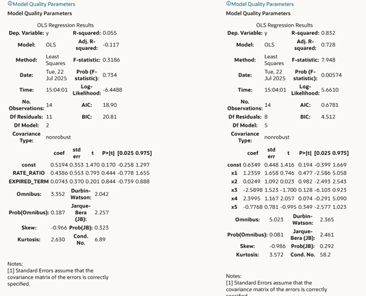

    Click Model Quality Parameter link to view Model Summary window, after saving all details. To verify the model quality, all the model statistics are given on a different screen, which would be available with Model Quality Parameter link like R2, F value, P – Value, and so on.
    Figure 6-357 Model Quality Parameter
    Add row using Add +. You can add multiple rows or delete multiple rows using buttons in panel 1. Default sample matrix is10*10, but once you re-define sample, matrix can be truncated to any dimensions. The redefined matrix will be saved along with model. Model summary parameters like R2 , AIC and BIC. Both (Linear/Polynomial) models are produced when the system compares model generated R2 against the R2 threshold defined by the user. The final option is given to you to choose any one of these models. Based on infrastructure availability and model complexity, you can choose any one of linear/polynomial model.
    Click Save Model to save the model. Same model could be referred to populate prepayment rate matrix. Click Calculate again to re-evaluate model based on changed model parameters.
    If you want to change sample size and re-calculate EDA again, click Exploratory Data Analysis step and perform EDA with updated sample size. Again, process would start from that step onwards and updated EDA plots/graphs would be saved for the model. If you want to update selected risk factors, click Risk Factor Selection step and change risk factors. Again, process would start from that step onwards and updated risk factors would be saved for the model.
    The Reset Default button on every step would help to delete all the calculations done in subsequent steps. That is, if you have done EDA and selected particular EDA version to do further calculations like ‘Risk factor Selection’ or ‘Model Evaluation’. In case you are not satisfied with model, you can go back to EDA, click Reset Default to clear out the details/calculations performed in subsequent stages and do recalculate with a different set of parameters. Following are the default values/usage of Parameters:
