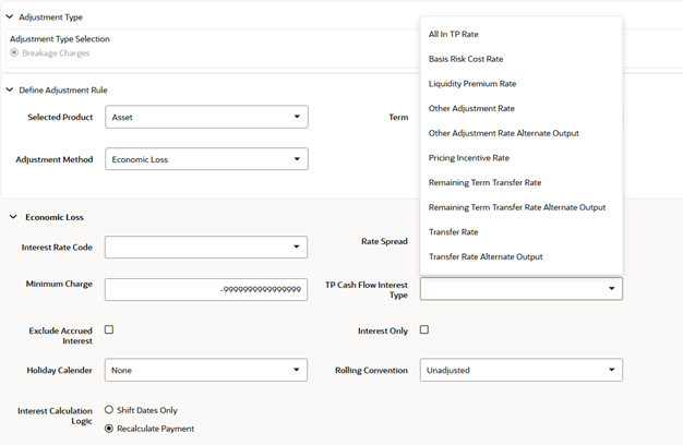

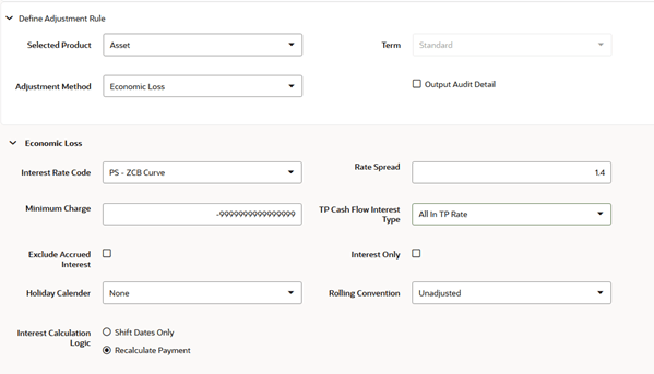

  1. Select the Interest Rate Code and Rate Spread to use for discounting the remaining term Cash Flows.
  2. Select the minimum charge amount. Default to -99999 if you want to calculate both gains and losses.
  3. Select the TP Cash Flow Interest Type. This interest rate will be used to generate Interest Cash Flows.
    Figure 6-289 Add-on Rule Definition Mode – TP Cash Flow Interest Type
  4. Select the option to Exclude Accrued Interest if applicable.
  5. Select the Interest Only option to discount only the Interest Cash Flows.
  6. Select a Holiday Calendar if you want to adjust Cash Flows for Holidays and Weekends.

  8. Select the appropriate Interest Calculation Logic from the following:
    • Shift Dates Only
    • Recalculate Payment
  9. Select Apply.
