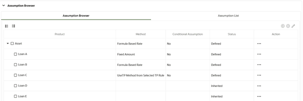

To define Assumptions for the Default Currency, select a Product from the hierarchy and “Default Currency” from the Currency list and proceed with the Assumption Definition as described above. When processing data, the Transfer Pricing engine will first look for an Assumption that exactly matches the Product/Currency of the Instrument Record. If not found, the engine will then look for the combination of the Product and the Default Currency. This is a useful option to utilize during setup when the same product exists across multiple currencies and shares the same Add-on Rate Assumption and Interest Rate Code.
Figure 6-280 Add-on Rule Definition with Default Currency
