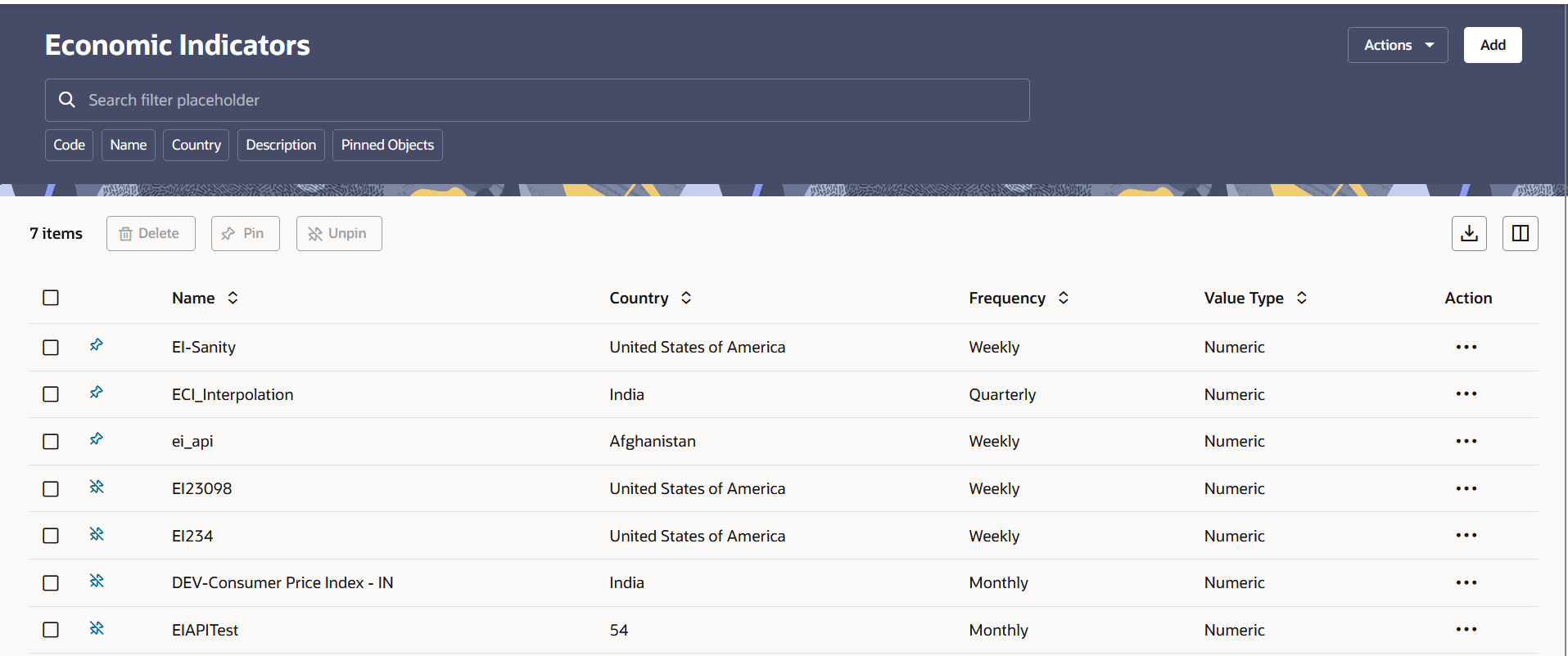

To view the Economic Indicators, navigate to Maintenance and then select Economic Indicators, an empty window is displayed. After you have defined one or more Economic Indicators, the Economic Indicators Summary Page shows all the Economic Indicators that you have previously defined.

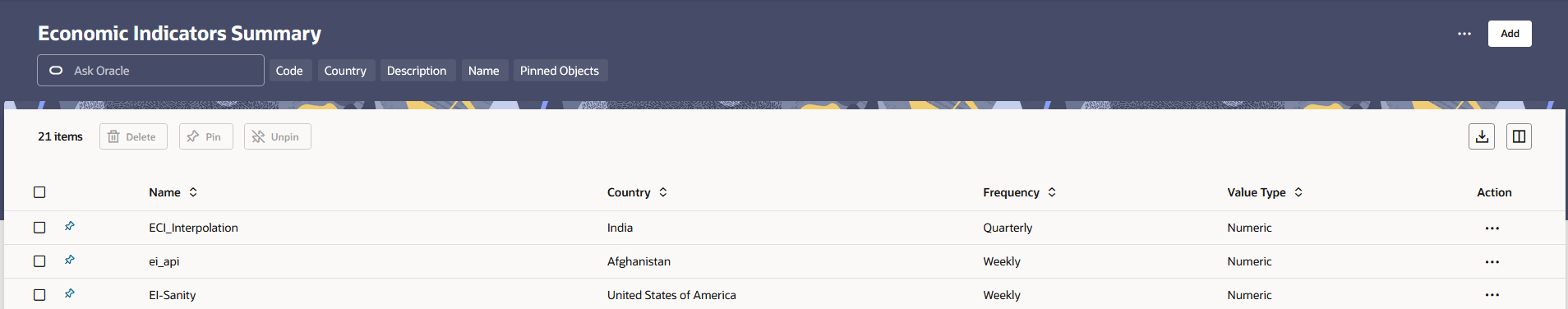

Figure 6-14 Economic Indicator Summary

The Economic Indicator Rule summary displays the following information:
Add: Click the Add icon on the page header to build a new Economic Indicator Rule.
More Actions: Enables you to perform following tasks.
  • Refresh: Retains the selected filters and refreshes the summary page with latest status.
  • Reset:Clears the selected filters and refreshes the summary page.
  • Help:Redirects you to latest documentation.
Delete: Enables you to select and delete one or multiple rules in the table simultaneously.
Pin/Unpin: Enables you to pin/unpin the selected rule.
Export: Enables you to download the summary page details in .CSV format.
Columns: Allows you to view the summary page data using a customized list of columns.
The Economic Indicator Rule summary table displays the following columns:
  • Name: The Economic Indicator Rule's name.
  • Country: The Country of for which Economic Indicator has been defined.
  • Frequency: The Frequency at which value of Economic Indicator is expected to be updated.
  • Hierarchy: Hierarchy that is used to define Economic Indicator Rule.
  • Value Type: The Value Type of an Economic Indicator.
  • Action: Click this icon to view a list of actions that you can perform on the Economic Indicator Rule.
    • View/Edit: Based on the user privilege assigned, you can either only view or edit existing Economic Indicator Rules. To edit a rule, you must have Read/Write privilege.
    • Save As: You can reuse the Economic Indicator Rule by saving it under a new name thus saving time and effort in entering data multiple times; it also leads to reduced data entry errors.
    • Delete: You can delete Economic Indicator Rules that you no longer require. Note that only Economic Indicator Rule owners and those with Read/Write privileges can delete Economic Indicator Rules. A Economic Indicator Rule that has a dependency cannot be deleted. A rule cannot be retrieved after deletion.
    • Dependency Check: You can perform a dependency check to know where a particular Economic Indicator Rule has been used. Before deleting a rule, it is always a good practice to do a dependency check to ensure you are not deleting Economic Indicator Rules that have dependencies. A report of all rules that utilize the selected Economic Indicator Rule is generated.
