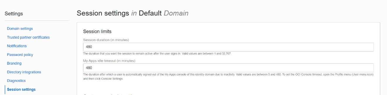

  2. Navigate to the Domain page. Click Settings and select Session Settings.
  3. Specify the Session Duration under Session Limits. Enter the required value. By default, this is set to 480 Minutes.
    Figure 3-6 Session Settings
    Session Settings
