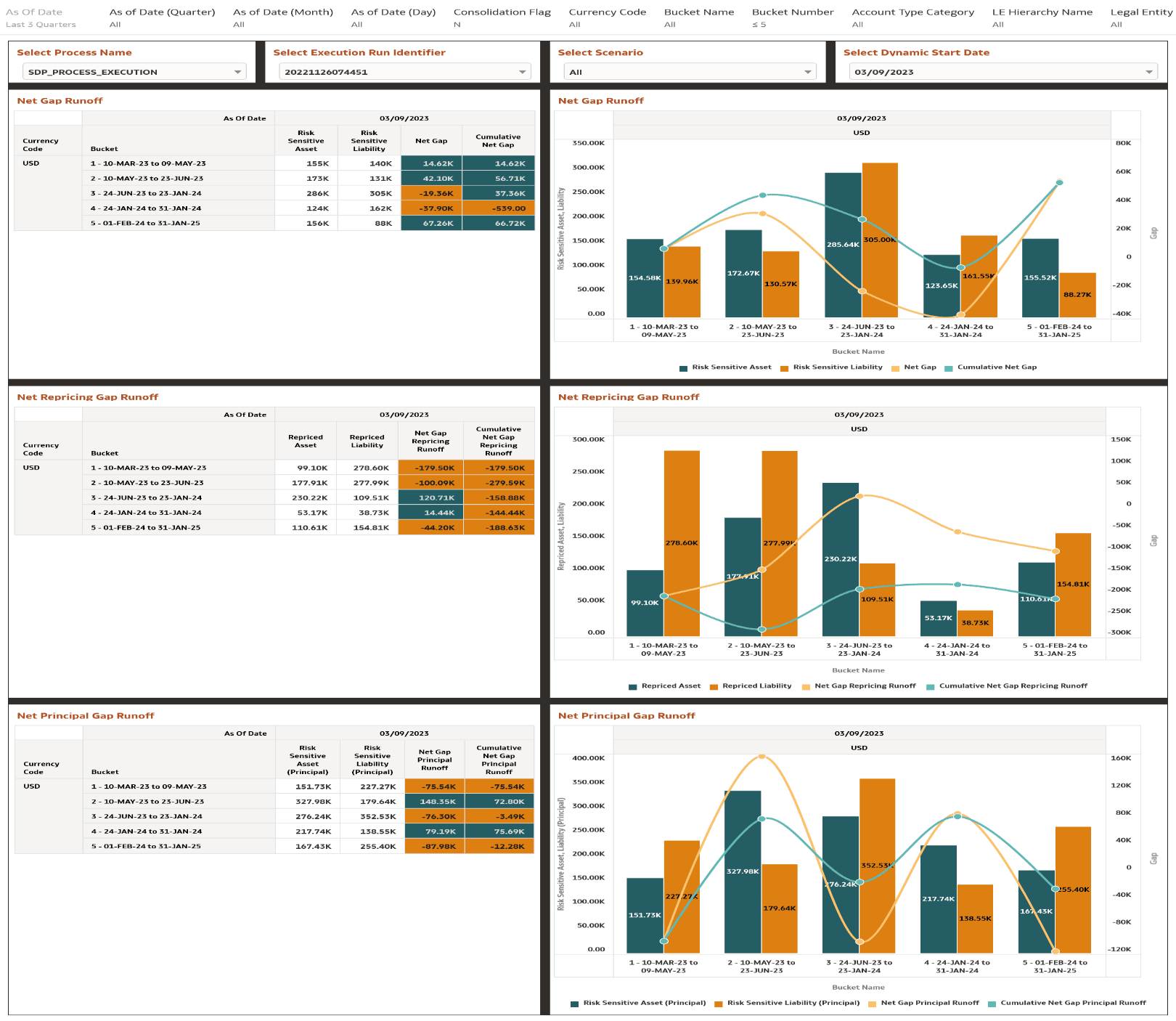

Interest Rate Risk Gap
The “Interest Rate Risk Gap” report is a statement of Risk Sensitive Assets, Risk Sensitive Liabilities and difference between the two.
You can use a series of Report Prompts, as previously described, to filter the data according to key attributes pertaining to the underlying Interest Rate Risk Output results.
The report displays the underlying data according to the following Chart’ logic:
  • Select Process Name
    The List box filter provides you with a selection capability on the desired Process Name utilized by the Interest Rate Risk Output processes. This is a Single select filter, without any selection the reports will not fetch any meaningful results.
  • Select Execution Run Identifier
    The List Box filter provides you with a selection capability on the desired Execution Run Identifier utilized by the Interest Rate Risk Output processes. This filter is dependent on the values selected in the Process Name filter. This is a Single select filter, without any selection the reports will not fetch any meaningful results.
  • Select Scenario
    The List box filter provides you with a selection capability on the desired Scenario utilized by the Interest Rate Risk Output processes. This filter is dependent on the values selected in the Process Name, Execution Run Identifier filter. This is a Single select filter, without any selection the reports will not fetch any meaningful results.
  • Select Dynamic Start Date
    The List box filter provides you with a selection capability on the desired Dynamic Start Date utilized by the Interest Rate Risk Output processes. This filter is dependent on the values selected in the Process Name, Execution Run Identifier, and Scenario filter. This is a Single select filter, without any selection the reports will not fetch any meaningful results.
  • Net Gap Runoff
    The chart reports the analysis of the Net Gap Runoff Value depending on the Account type Category processed for each Bucket with respect to As of Date and Dynamic Start Date.
    The columns displayed in the chart are the following:
    • Currency Code
    • Bucket Name
    • As Of Date (Day)
    • Account Type Category
    • Risk Sensitive Asset
    • Risk Sensitive Liability
    • Net Gap
    • Cumulative Net Gap
  • Net Repricing Gap Runoff
    The chart reports the analysis of the Net Repricing Gap Runoff Value depending on the Account type Category processed for each Bucket with respect to As of Date and Dynamic Start Date.
    • Currency Code
    • Bucket Name
    • As Of Date (Day)
    • Repriced Asset
    • Repriced Liability
    • Net Gap Repricing Runoff
    • Cumulative Net Gap Repricing Runoff
  • Net Principal Gap Runoff
    The chart reports the analysis of the Net Principal Gap Runoff Value depending on the Account type Category processed for each Bucket with respect to As of Date and Dynamic Start Date.
    • Currency Code
    • Bucket Name
    • As Of Date (Day)
    • Risk Sensitive Asset (Principal)
    • Risk Sensitive Liability (Principal)
    • Net Gap Principal Runoff
    • Cumulative Net Gap Principal Runoff
Figure 8-141 Interest Rate Risk GAP Report
