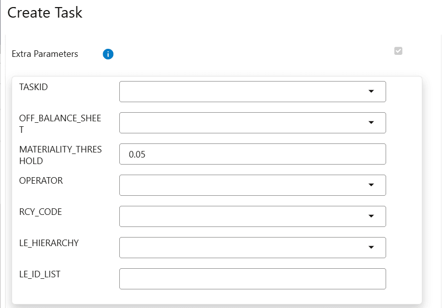

Execution of Material Currency
To execute the Material Currency, follow these steps:
  1. Navigate to Operations and Processes menu, and select Scheduler.
  2. Navigate to Schedule Batch and search Material_Currency_Identifier batch.
  3. Modify the parameters as required.
  4. Click Execute.
  5. You can view the execution status in Monitor Batch window.
