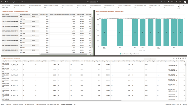

The Ledger – Instrument Report provides the analysis capability on the Ledger Instrument Table.
You can use a series of Report Prompts to filter the data according to functional key attributes pertaining to the table columns perimeter.
The report displays the underlying data according to the following Charts’ logic:
  • Ledger Instrument - Aggregated Statistics
    Aggregation for CUR_PAR_BAL (sum), ORG_PAR_BAL (sum) and CUR_NET_RATE (avg) by AS_OF_DATE, ISO_CURRENCY_CD and PRODUCT_ID.
    In addition, for CUR_NET_RATE, the additional Balance Weighted Rate, WAVG_CUR_NET_RATE_LEDGER_INSTRUMENTS, is calculated as the Weighted AVG by CUR_PAR_BAL.
  • Ledger Instrument - Number of Records Trend
    Total Records Ledger Instruments aggregated by AS_OF_DATE.
  • Ledger Instrument
    Granular table records at ACCOUNT_NUMBER level.
Figure 8-48 Processing Instrument Data – Ledger Instruments
