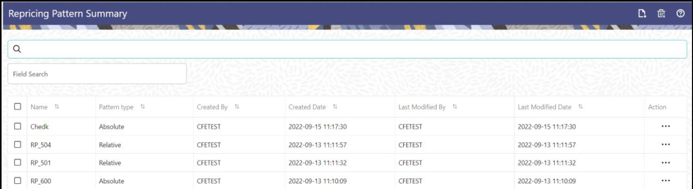

Figure 6-52 Repricing Summary

The Repricing Pattern Summary displays the following information:
Add: Click the Add icon on the page header to build a new Repricing Pattern.
Multiple Delete: Enables you to select and delete one or multiple rules in the table simultaneously.
  • Name: The Repricing Pattern's short name.
  • Pattern Type: The Repricing Pattern Type, such as Absolute or Relative.
  • Created By: The Name of the user who created the Repricing Pattern.
  • Created Date: The Date and Time at which the Repricing Pattern was created.
  • Last Modified By: The user who last modified the Repricing Pattern.
  • Last Modified Date: The Date and Time when the Repricing Pattern was last modified.
  • Action: Click this icon to view a list of actions that you can perform on the Repricing Pattern.
