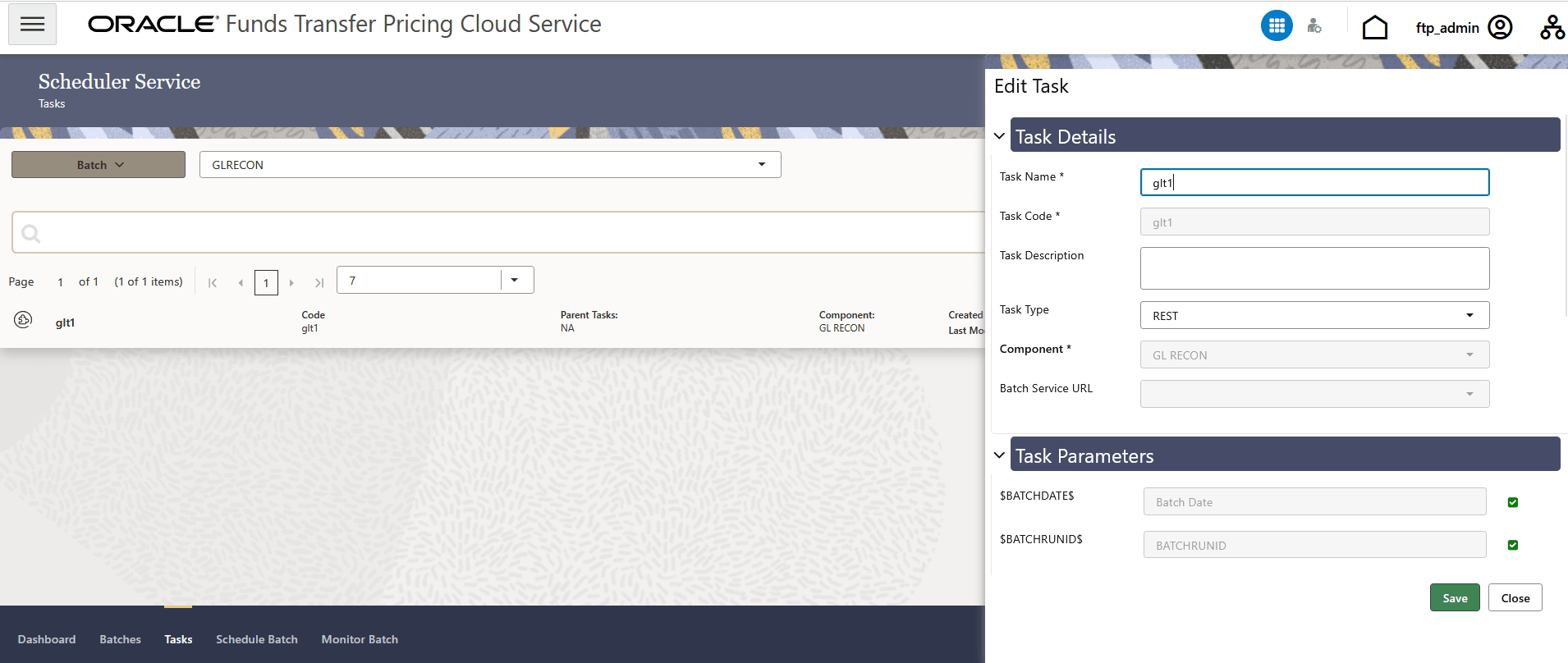

  6. In the Create Task screen, enter the following values:
    1. Task Code (Spaces are not allowed in the code section). b.
    2. Task Name.
    3. Select the task type as REST.
    4. Select the Component as GL RECON.
    5. Click Save.
    When the GL RECON component is selected, the Batch Service URL field is not displayed and does not require configuration.
    Figure 3-59 Define Task
    Define Task

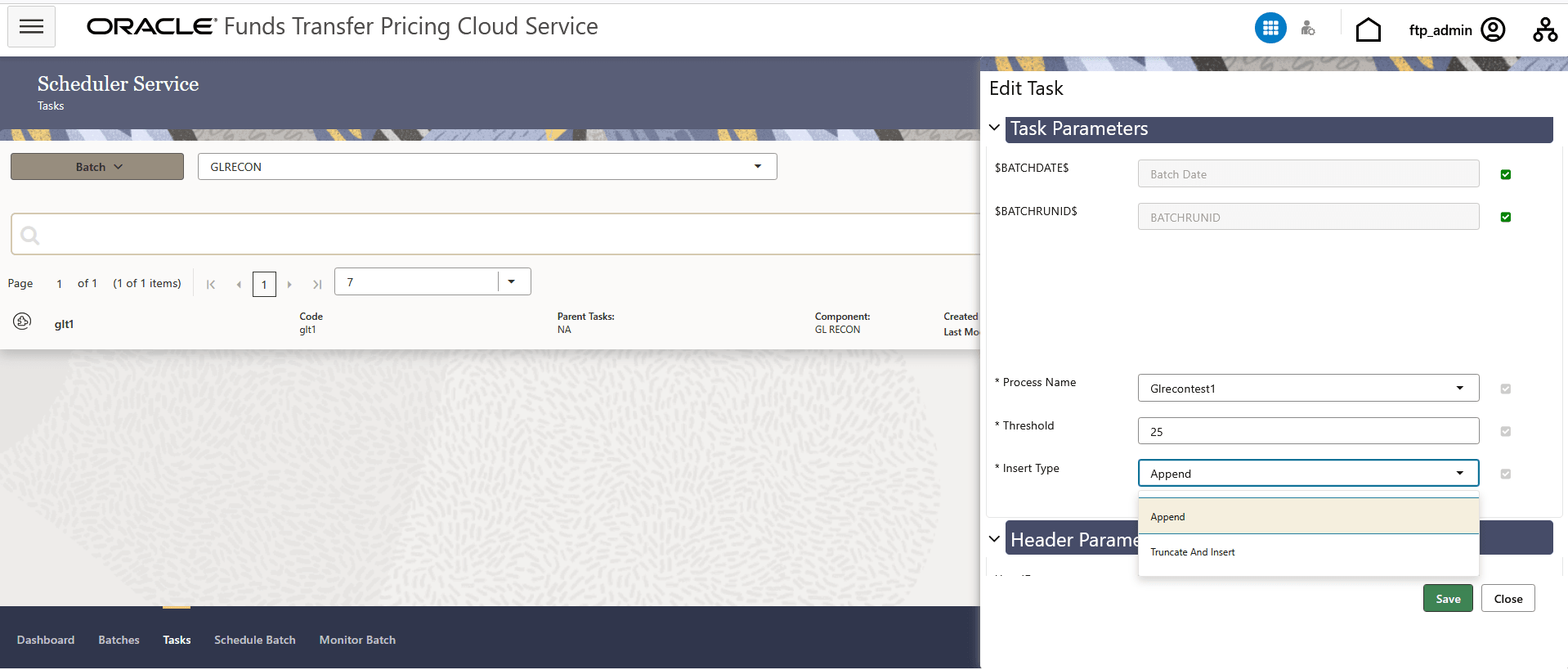

  7. In the Task Parameter section, enter the following values:
    1. Process Name — Select the Reconciliation Definition for which the batch should be executed. Ensure you select the correct definition to avoid errors in the batch process.
    2. Threshold — Enter a numeric threshold value.
      The value must be greater than or equal to zero (0). Negative values are not supported. A null (blank) value is also accepted, in which case all data will be inserted into the Ledger Instrument and Reconciliation Difference Audit tables.
    3. Insert Type — Select one of the following options from the dropdown:
      • Insert only — Appends reconciliation data on top of any existing data for the concerned AS_OF_DATE/MIS_DATE. Use this option when different Reconciliation Definitions are being executed for different instrument tables.
      • Truncate And Insert — Truncates all existing data for the concerned AS_OF_DATE/MIS_DATE and inserts fresh reconciliation data. Use this option when intermediate day runs have taken place and a final global run is required.
    Figure 3-60 Task Parameter
    Task Parameter
