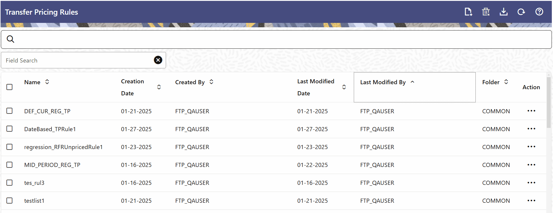

To create a Transfer Pricing Rule, from the LHS menu, select Assumption Specification, and then select Transfer Pricing Rules.
The Transfer pricing Rules summary screen is displayed showing a set of Transfer Pricing Rules. Using search criteria, you can control the set of rules that are displayed. When you Add, Edit, or View a rule, a detailed screen is displayed.
Figure 6-269 Transfer Pricing Rules summary

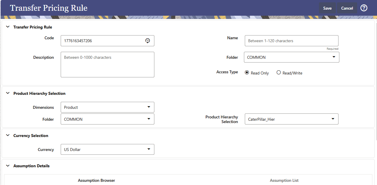

To create a new rule:
  1. In the Transfer Pricing Rules summary screen, click Add.
  2. In the Code field, the code is auto-generated.
    • You can also manually enter a numeric code.
    • Only numerical values are allowed; special characters are not permitted.
  3. In the Name field, enter a descriptive name for the rule (1–120 characters). This is a required field.
  4. Optional: In the Description field, enter a description (0–1000 characters).
  5. In the Folder, Product Hierarchy, and Currency Selection fields, values are provided by default.
    • You can search the rule on any of the product dimensions.
    • The searched dimension and currency will be auto-populated while defining the rule.
    • If needed, you can change the default product dimension.
  6. Under the Assumption Details section, do the following:
    1. Expand the Assumption Details section.
    2. For each product node, click either Add or Conditional Assumption.
Figure 6-270 Transfer Pricing Rule definition screen
You can search the rule on any of the product dimension, searched dimension will be auto-populated while defining the rule; if you like, you can change the default product dimension.
