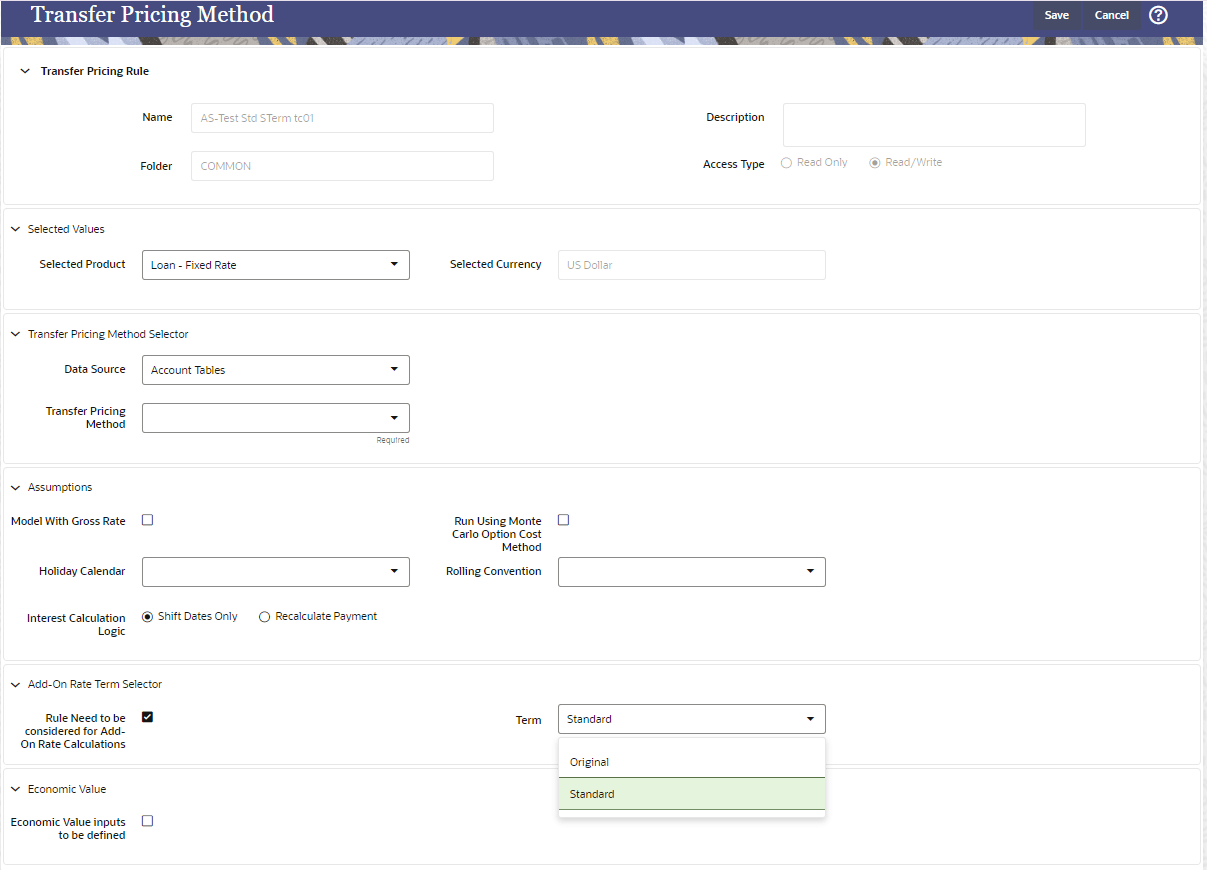

  • Term: The following Term Types are available:
    • Standard Term: Add-on rate would be calculated as per the repricing period for adjustable-rate instruments and use the original term (maturity date - origination date) for fixed-rate instruments.
    • Original Term: Add-on Rates would be calculated as per the original term like a fixed-rate instrument.
Figure 7-286 Add-On rate Method – Use TP Method (Term Selection)
