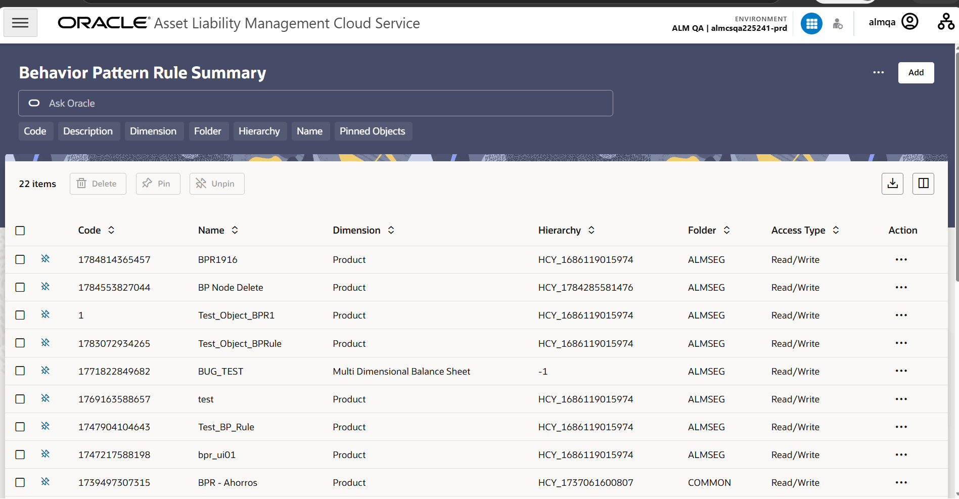

Behavior Pattern Rule Summary
This page is the gateway to all Behavior Pattern Rules and related functionality. You can navigate to other pages relating to Behavior Pattern Rules from this point.
Figure 7-113 Behavior Pattern Rule Summary

An alternative method to search a Behavior Pattern rule is through the Field Search option. This is an inline wildcard UI search that allows you to enter a search value (such as code, name, etc.) partially or fully. Rows that contain the string you are searching for are fetched and displayed in the Behavior Pattern rule Summary. You can enter the Code, Name, Description, Dimension, Hierarchy, and Folder of the Behavior Pattern Rule and click Search.
The Behavior Pattern rule Summary displays the following information:
