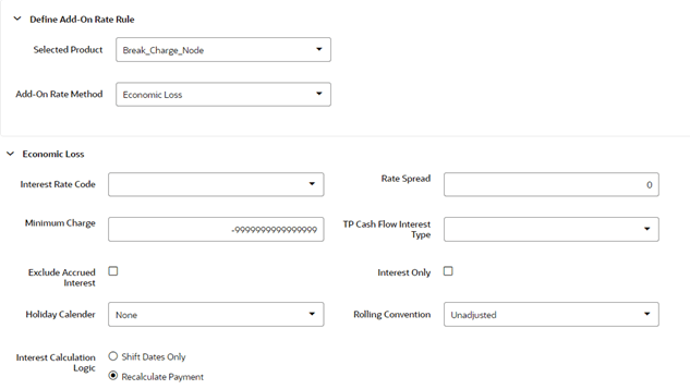

Figure 7-289 Breakage Charge - Economic Loss

If you are calculating Breakage Charges, using the Economic Loss method, you must select the "Remaining Term" option in your Transfer Pricing Process, to generate the correct Cash Flows for the funding liability.Both Current and Prior Period Cash Flows will be logged which are used for Break Charge Calculations in FSI_O_CFE_OUTPUT_HIST table using the Record Sequence (n,n+1) for Prior/Current Period Record, respectively. Record sequence is concatenated with Account Number, so you can identify Cash Flows belonging to prior/current period record.
