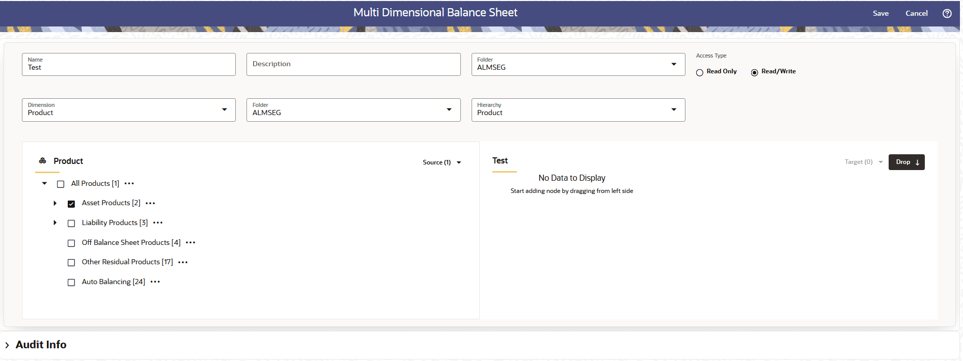

    Based on the selected Dimension from Dimension drop-down list, the Dimension Source selection options will vary. For example,
    • If Dimension is selected as “Product”, then Product Folder and Product Hierarchy fields will be available.
      Figure 7-19 MDBSS Rule
      MDBSS Rule

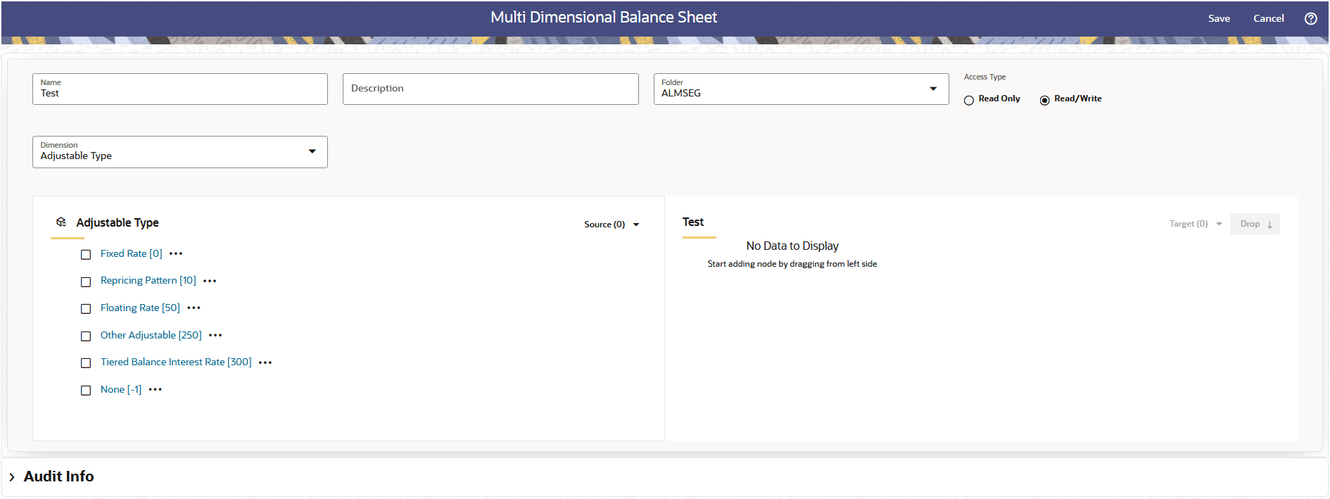

    • If Dimension is selected as “Adjustable Type”, then only list of Adjustable Types will be available.
      Figure 7-20 MDBSS Rule
      MDBSS Rule
