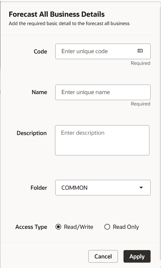

  1. Click Add icon from the top of the Forecast All Business Rule Summary page. The Forecast All Business Details page is displayed.
    Figure 7-186 Forecast All Business Details Page
  2. Enter the following details and click Apply.
    Table 7-47 Create Forecast All Business Rule
    Fields Description
    Code Enter the code manually, or click Autogenerate to generate it automatically.
    Name Enter the name of the Forecast All Business Rule.
    Description Enter the description of the Forecast All Business Rule. This is an optional field.
    Folder Select the Folder where the Forecast All Business Rule needs to be saved.
    Access Type Select the Access Type as Read-Only or Read/Write.

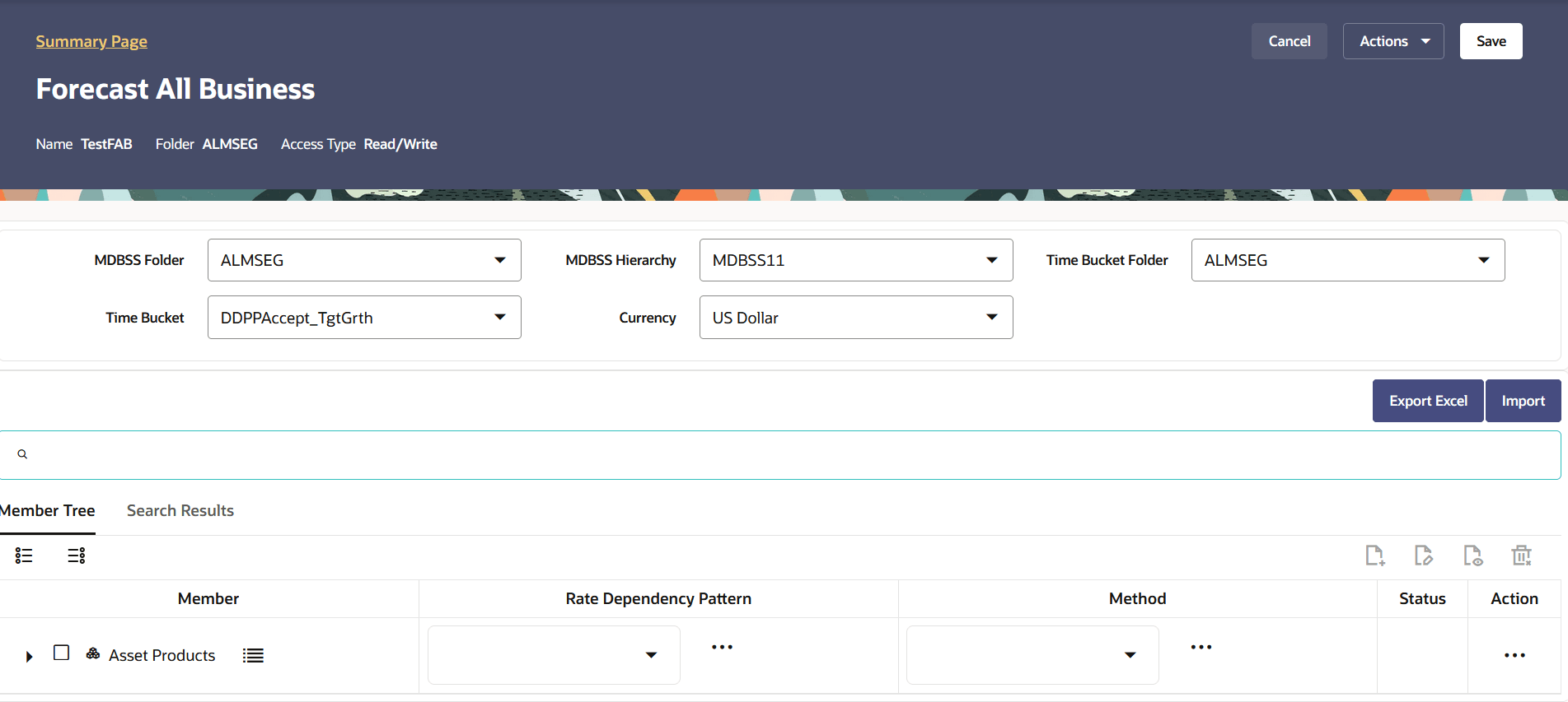

  3. The Forecast All Balance Rule page is displayed.
    Figure 7-187 Forecast All Balance Rule page
    Click Save button to save the draft of Forecast All Business rule.
    You can click on Actions drop-down to view the Detail Info and Audit Info of Forecast All Business rule.
    Figure 7-188 Actions drop-down
    Actions drop-down
    The Detail Info shows the basic details of rule, such as, Forecast All Business rule Name. Description, Folder Name, and Access Type.
    The Audit Info shows the audit details of rule.
    Enter the following details:
    Table 7-48 Create Forecast All Business Rule
    Fields Description
    MDBSS Folder and MDBSS Hierarchy Select the MDBSS folder and MDBSS hierarchy
    Time Bucket Folder and Time Bucket Select the Time Bucket folder and Time Bucket
    Currency Select the currency for Forecast All Business Rule
    If any member is a currency in the MDBSS hierarchy (for example, INR) and selected currency is different (for example, USD), then the member and its children nodes can not be defined.
  4. Select MDBSS node(s) from Member Tree tab of Assumption Browser. Assumption Browser has two tabs: Member Tree and Search Results.
