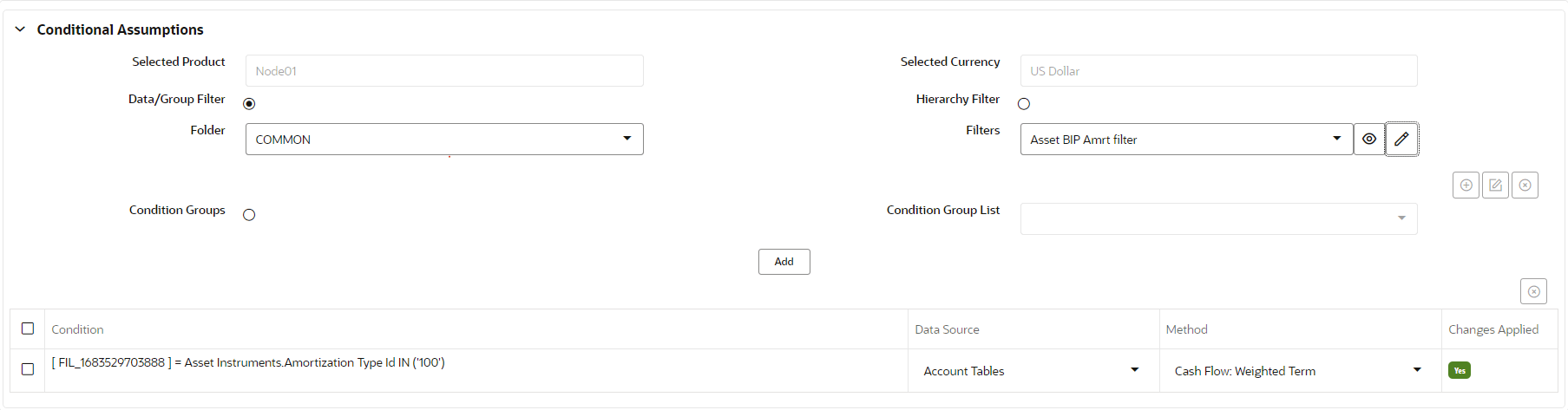

The Conditional Assumption screen allows users to select explicit conditions (from Data Filters and/or Hierarchy Filters), apply methods, and rule selections to each condition directly. The Filter Conditions are processed by the engine in the order that they appear on the screen. After a condition is satisfied, the related assumption is applied. The following figure displays a representative Conditional Assumption using a Data Filter:
Figure 7-267 Conditional Assumptions
The Filters field displays the View and Edit buttons. You can verify the existing Filters by clicking the View button. Click the Edit button if you want to modify the Filter condition.
If an instrument record does not meet any of the conditions, then the rule logic reverts to the standard assumption that is directly assigned to the Product / Currency combination.
